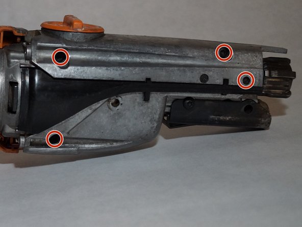

  4. Ridgid GEN5X R8642 Blade Clamp Assembly Replacement: crwdns2935265:04crwdnd2935265:01crwdnd2935265:01crwdne2935265:0
    • Use a JIS #1 screwdriver to remove the two M4 x 25mm screws on both sides of the metal housing.

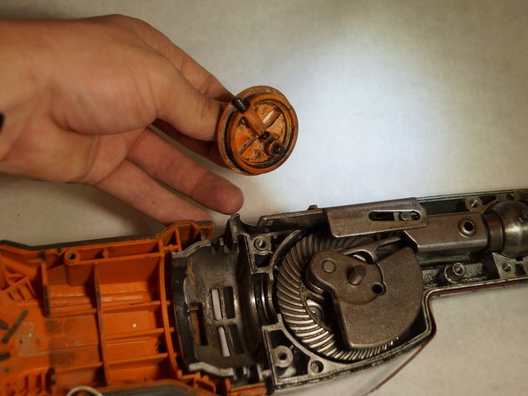

  7. Ridgid GEN5X R8642 Blade Clamp Assembly Replacement: crwdns2935265:07crwdnd2935265:01crwdnd2935265:03crwdne2935265:0 Ridgid GEN5X R8642 Blade Clamp Assembly Replacement: crwdns2935265:07crwdnd2935265:02crwdnd2935265:03crwdne2935265:0 Ridgid GEN5X R8642 Blade Clamp Assembly Replacement: crwdns2935265:07crwdnd2935265:03crwdnd2935265:03crwdne2935265:0

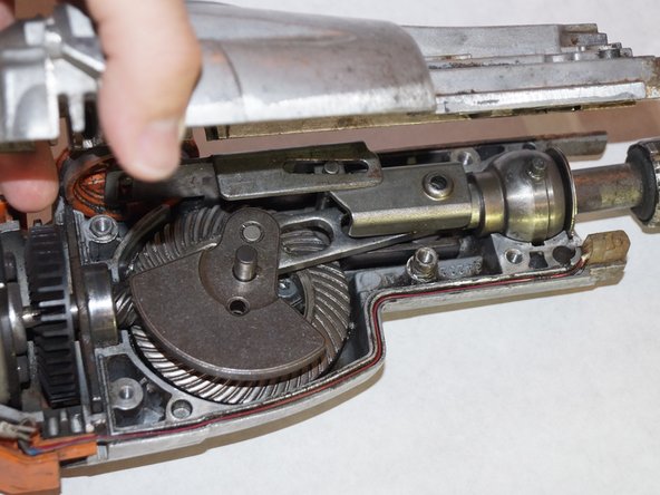

    • Remove the five T20 Torx screws from the gear assembly cover and pull the cover off.
  8. Ridgid GEN5X R8642 Blade Clamp Assembly Replacement: crwdns2935265:08crwdnd2935265:01crwdnd2935265:02crwdne2935265:0 Ridgid GEN5X R8642 Blade Clamp Assembly Replacement: crwdns2935265:08crwdnd2935265:02crwdnd2935265:02crwdne2935265:0
    • Carefully remove the motor making sure not to harm any of the wires that are attached. Place motor gently out of the way.

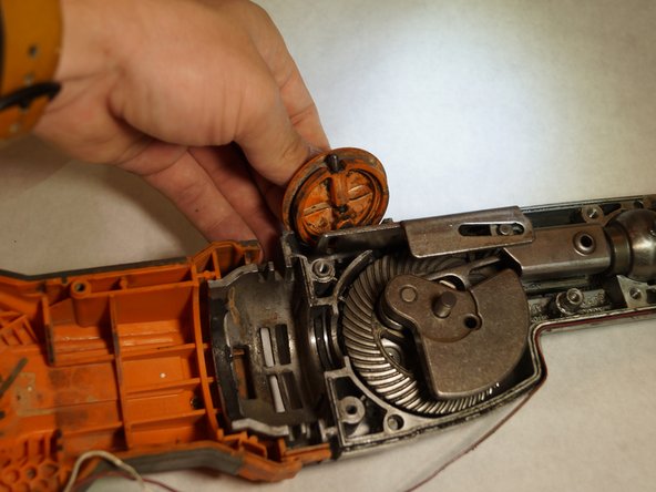

  9. Ridgid GEN5X R8642 Blade Clamp Assembly Replacement: crwdns2935265:09crwdnd2935265:01crwdnd2935265:03crwdne2935265:0 Ridgid GEN5X R8642 Blade Clamp Assembly Replacement: crwdns2935265:09crwdnd2935265:02crwdnd2935265:03crwdne2935265:0 Ridgid GEN5X R8642 Blade Clamp Assembly Replacement: crwdns2935265:09crwdnd2935265:03crwdnd2935265:03crwdne2935265:0
    • Remove the orbital switch by pulling straight up on it.
    • Be careful to not lose the spring and pin that is inside of the switch.
  10. Ridgid GEN5X R8642 Blade Clamp Assembly Replacement: crwdns2935265:010crwdnd2935265:01crwdnd2935265:03crwdne2935265:0 Ridgid GEN5X R8642 Blade Clamp Assembly Replacement: crwdns2935265:010crwdnd2935265:02crwdnd2935265:03crwdne2935265:0 Ridgid GEN5X R8642 Blade Clamp Assembly Replacement: crwdns2935265:010crwdnd2935265:03crwdnd2935265:03crwdne2935265:0
    • Remove the gear assembly by pulling it straight up.

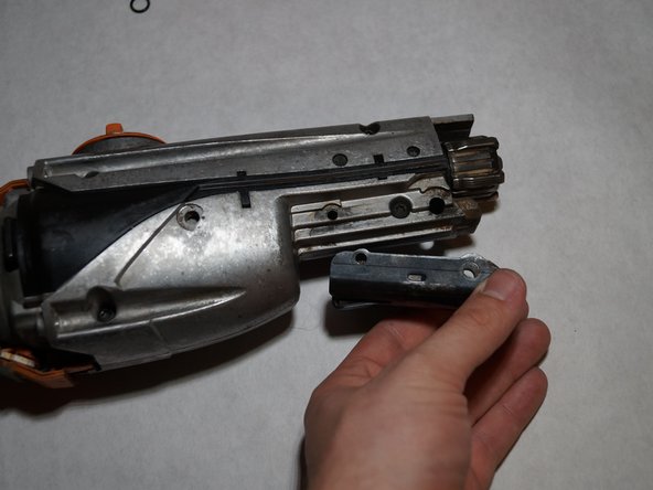

  11. Ridgid GEN5X R8642 Blade Clamp Assembly Replacement: crwdns2935265:011crwdnd2935265:01crwdnd2935265:03crwdne2935265:0 Ridgid GEN5X R8642 Blade Clamp Assembly Replacement: crwdns2935265:011crwdnd2935265:02crwdnd2935265:03crwdne2935265:0 Ridgid GEN5X R8642 Blade Clamp Assembly Replacement: crwdns2935265:011crwdnd2935265:03crwdnd2935265:03crwdne2935265:0
    • Pull the pin holding the metal guide housing in place.
    • Slide the metal guide housing back off the gear assembly.

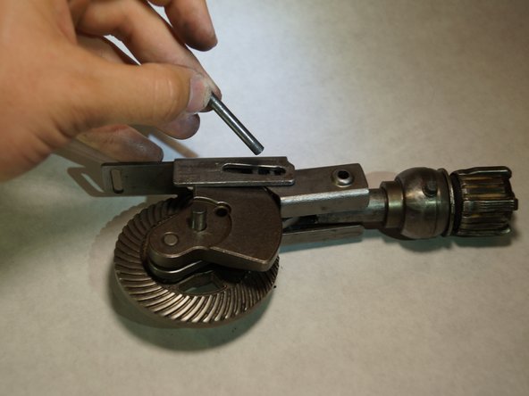

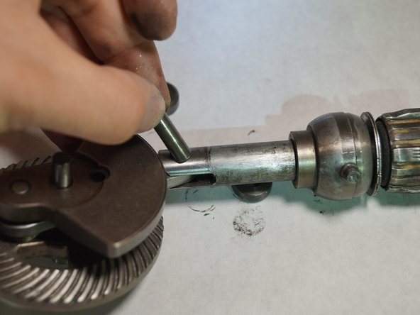

  12. Ridgid GEN5X R8642 Blade Clamp Assembly Replacement: crwdns2935265:012crwdnd2935265:01crwdnd2935265:02crwdne2935265:0 Ridgid GEN5X R8642 Blade Clamp Assembly Replacement: crwdns2935265:012crwdnd2935265:02crwdnd2935265:02crwdne2935265:0
    • Remove the guide bushing by pulling up on it.
    • Then slide the pin out that holds the gear assembly and blade clamp assembly.
  13. Ridgid GEN5X R8642 Blade Clamp Assembly Replacement: crwdns2935265:013crwdnd2935265:01crwdnd2935265:01crwdne2935265:0
    • Slide the blade clamp assembly off the gear assembly.
