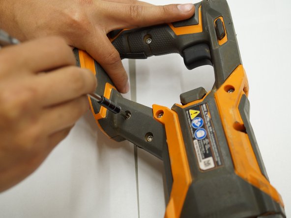

  3. Ridgid GEN5X R8642 Battery Port Replacement: crwdns2935265:03crwdnd2935265:01crwdnd2935265:03crwdne2935265:0 Ridgid GEN5X R8642 Battery Port Replacement: crwdns2935265:03crwdnd2935265:02crwdnd2935265:03crwdne2935265:0 Ridgid GEN5X R8642 Battery Port Replacement: crwdns2935265:03crwdnd2935265:03crwdnd2935265:03crwdne2935265:0
    • Use a T20 Torx screwdriver to remove the nine M4 X 16mm screws from the plastic housing.

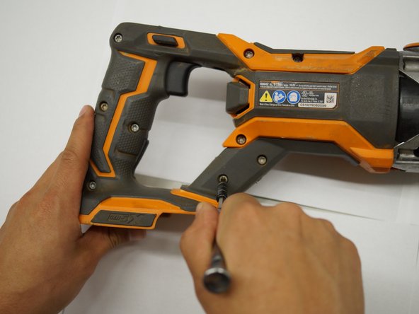

  4. Ridgid GEN5X R8642 Battery Port Replacement: crwdns2935265:04crwdnd2935265:01crwdnd2935265:01crwdne2935265:0
    • Use a JIS #1 screwdriver to remove the two M4 x 25mm screws on both sides of the metal housing.
