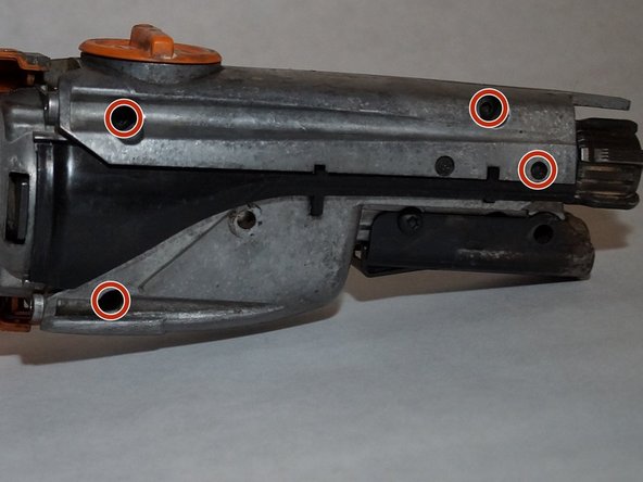

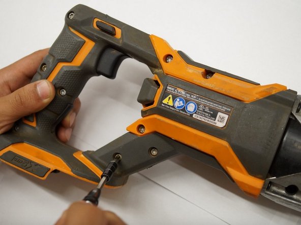

    • Use a T20 Torx screwdriver to remove the nine M4 X 16mm screws from the plastic housing.
  4. Ridgid GEN5X R8642  Motor Replacement: crwdns2935265:04crwdnd2935265:01crwdnd2935265:01crwdne2935265:0
    • Use a JIS #1 screwdriver to remove the two M4 x 25mm screws on both sides of the metal housing.

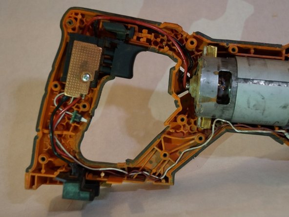

    • Remove one half of the plastic housing using a spudger so that the internal system is exposed.
  6. Ridgid GEN5X R8642  Motor Replacement: crwdns2935265:06crwdnd2935265:01crwdnd2935265:02crwdne2935265:0 Ridgid GEN5X R8642  Motor Replacement: crwdns2935265:06crwdnd2935265:02crwdnd2935265:02crwdne2935265:0
    • Remove the one 16mm T20 screw that holds the grip support onto the saw.

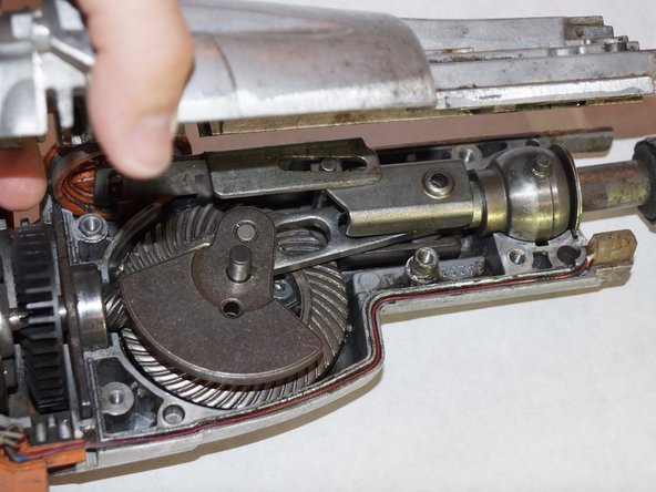

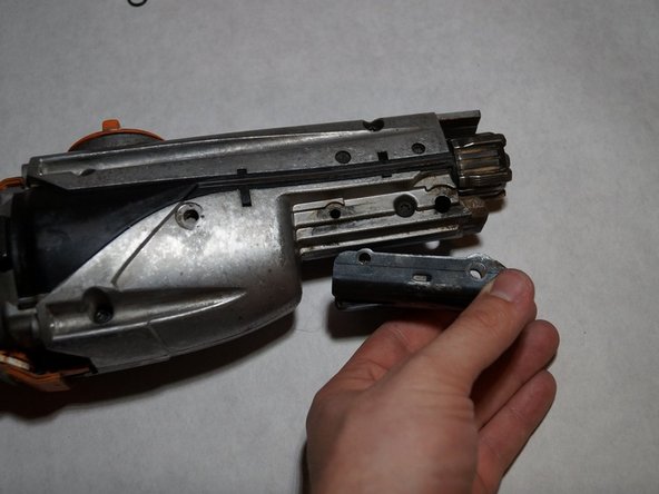

    • Remove the five T20 Torx screws from the gear assembly cover and pull the cover off.

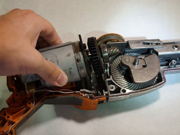

    • Carefully remove the motor making sure not to harm any of the wires that are attached. Place motor gently out of the way.

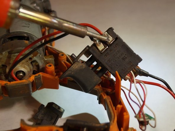

    • Remove the plastic wire covers to the red and black connections on the switch assembly.
    • When you remove the wire covers, you should be able to see the solder on the wires.
    • Desolder the connections on both the red and black wire using a soldering iron.
    • Once the solder is removed, pull out the wires with the battery port attached to the wires.
  10. Ridgid GEN5X R8642  Motor Replacement: crwdns2935265:010crwdnd2935265:01crwdnd2935265:01crwdne2935265:0
    • Remove the soldered connection from the switch assembly.
  11. Ridgid GEN5X R8642  Motor Replacement: crwdns2935265:011crwdnd2935265:01crwdnd2935265:02crwdne2935265:0 Ridgid GEN5X R8642  Motor Replacement: crwdns2935265:011crwdnd2935265:02crwdnd2935265:02crwdne2935265:0
    • Solder both connections of the new motor replacement to the switch assembly.
