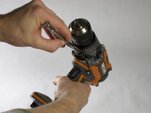

  3. Ridgid GEN5X R8611506 Trigger Replacement: crwdns2935265:03crwdnd2935265:01crwdnd2935265:02crwdne2935265:0 Ridgid GEN5X R8611506 Trigger Replacement: crwdns2935265:03crwdnd2935265:02crwdnd2935265:02crwdne2935265:0
    • Orient the drill to where the chuck is facing up.
    • Using the Torx T15 screwdriver, remove the four 8.0mm screws from the front of the drill.

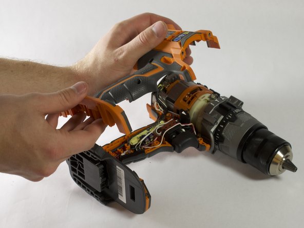

  4. Ridgid GEN5X R8611506 Trigger Replacement: crwdns2935265:04crwdnd2935265:01crwdnd2935265:02crwdne2935265:0 Ridgid GEN5X R8611506 Trigger Replacement: crwdns2935265:04crwdnd2935265:02crwdnd2935265:02crwdne2935265:0
    • Orient the drill so the side with the screw holes is facing up.
    • Use a plastic opening tool to gently pry the face off of the drill.
    • Remove the face completely from the drill.
  5. Ridgid GEN5X R8611506 Trigger Replacement, Trigger: crwdns2935265:05crwdnd2935265:01crwdnd2935265:01crwdne2935265:0
    • Use a plastic opening tool to gently pry the trigger from the brown connector.
