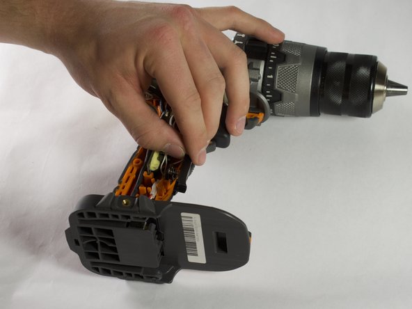

  5. Ridgid GEN5X R8611506 Light Switch Replacement, Light Switch: crwdns2935265:05crwdnd2935265:01crwdnd2935265:02crwdne2935265:0 Ridgid GEN5X R8611506 Light Switch Replacement, Light Switch: crwdns2935265:05crwdnd2935265:02crwdnd2935265:02crwdne2935265:0
    • Locate the light switch near the bottom of the drill's inner components.
    • Gently remove the light switch from the casing.
