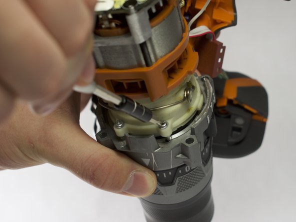

  8. Ridgid GEN5X R8611506 Gears Replacement: crwdns2935265:08crwdnd2935265:01crwdnd2935265:02crwdne2935265:0 Ridgid GEN5X R8611506 Gears Replacement: crwdns2935265:08crwdnd2935265:02crwdnd2935265:02crwdne2935265:0
    • Orient the motor and chuck to where the back of the motor is facing up.
    • Using a Phillips #0 screwdriver, remove the four 5.0mm screws that connect the motor to the chuck.
  9. Ridgid GEN5X R8611506 Gears Replacement: crwdns2935265:09crwdnd2935265:01crwdnd2935265:02crwdne2935265:0 Ridgid GEN5X R8611506 Gears Replacement: crwdns2935265:09crwdnd2935265:02crwdnd2935265:02crwdne2935265:0
    • Pull apart the motor from the chuck to expose the gears.
    • Remove the four gears located within the motor/chuck housing.
