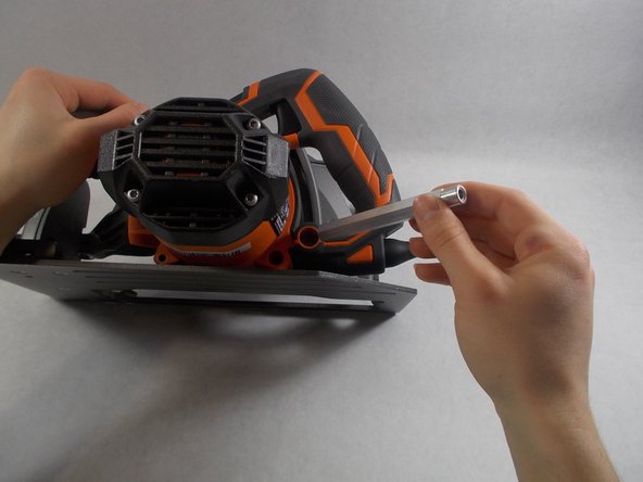

  1. Ridgid Circular Saw R3205 Switch Replacement, Motor Housing with Handle Assembly: crwdns2935265:01crwdnd2935265:01crwdnd2935265:03crwdne2935265:0 Ridgid Circular Saw R3205 Switch Replacement, Motor Housing with Handle Assembly: crwdns2935265:01crwdnd2935265:02crwdnd2935265:03crwdne2935265:0 Ridgid Circular Saw R3205 Switch Replacement, Motor Housing with Handle Assembly: crwdns2935265:01crwdnd2935265:03crwdnd2935265:03crwdne2935265:0
    • Remove the brush assembly with a flat head screwdriver.

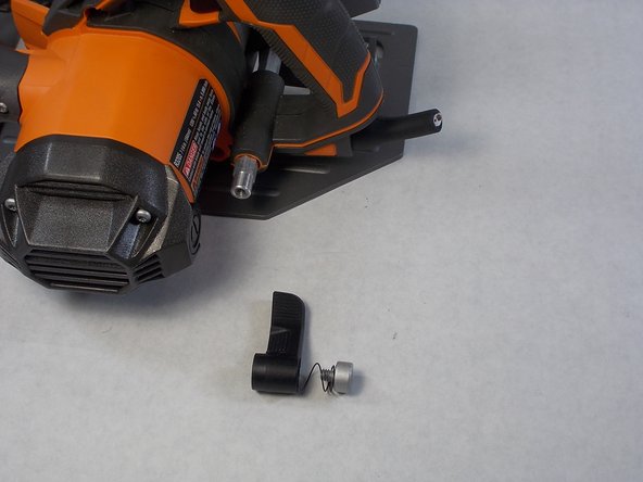

  3. Ridgid Circular Saw R3205 Switch Replacement: crwdns2935265:03crwdnd2935265:01crwdnd2935265:03crwdne2935265:0 Ridgid Circular Saw R3205 Switch Replacement: crwdns2935265:03crwdnd2935265:02crwdnd2935265:03crwdne2935265:0 Ridgid Circular Saw R3205 Switch Replacement: crwdns2935265:03crwdnd2935265:03crwdnd2935265:03crwdne2935265:0
    • Use a T20 Torx screwdriver to remove the (1/4-20 x 0.66 in.) screw.
    • After removing the (1/4-20 x 0.66 in.) screw the lever assembly can be unscrewed from the (1/4-20 x 0.66 in.) screw.

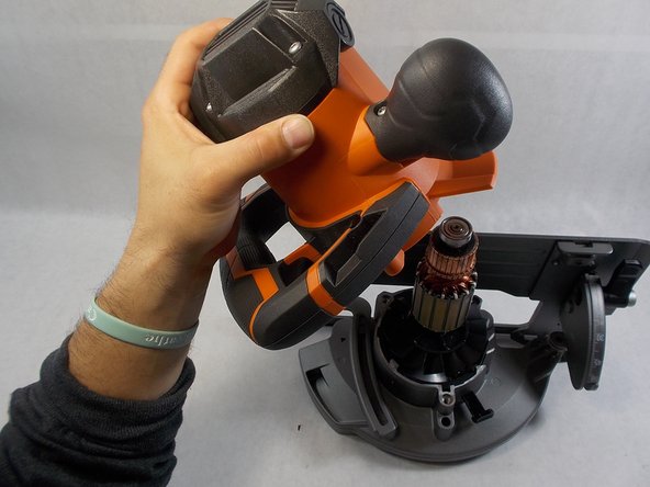

  4. Ridgid Circular Saw R3205 Switch Replacement: crwdns2935265:04crwdnd2935265:01crwdnd2935265:02crwdne2935265:0 Ridgid Circular Saw R3205 Switch Replacement: crwdns2935265:04crwdnd2935265:02crwdnd2935265:02crwdne2935265:0
    • The motor housing assembly can now be removed from the rest of the saw.

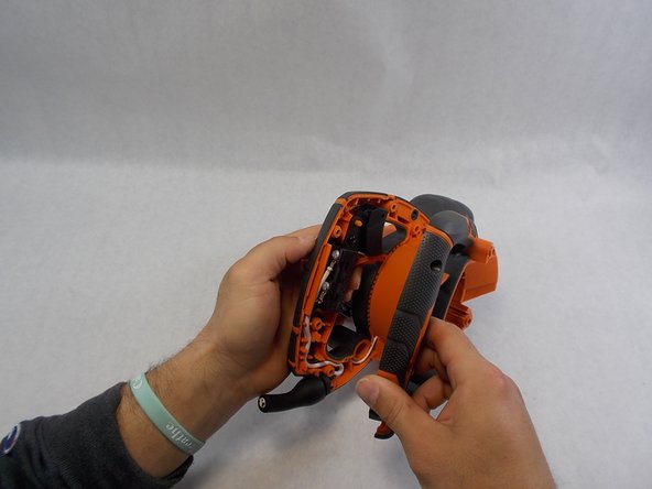

  5. Ridgid Circular Saw R3205 Switch Replacement, Switch: crwdns2935265:05crwdnd2935265:01crwdnd2935265:01crwdne2935265:0
    • Remove 5 Torx 20 (#8-16 x 5/8 in.) screws from the outer handle.
  6. Ridgid Circular Saw R3205 Switch Replacement: crwdns2935265:06crwdnd2935265:01crwdnd2935265:03crwdne2935265:0 Ridgid Circular Saw R3205 Switch Replacement: crwdns2935265:06crwdnd2935265:02crwdnd2935265:03crwdne2935265:0 Ridgid Circular Saw R3205 Switch Replacement: crwdns2935265:06crwdnd2935265:03crwdnd2935265:03crwdne2935265:0
    • Remove the outer handle.

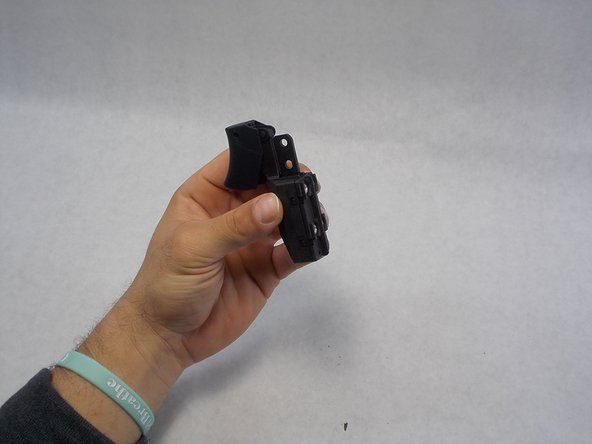

  7. Ridgid Circular Saw R3205 Switch Replacement: crwdns2935265:07crwdnd2935265:01crwdnd2935265:01crwdne2935265:0
    • Using a phillips head screwdriver remove the (M4 x 12 mm) screw holding the switch in place.

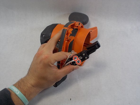

  8. Ridgid Circular Saw R3205 Switch Replacement: crwdns2935265:08crwdnd2935265:01crwdnd2935265:03crwdne2935265:0 Ridgid Circular Saw R3205 Switch Replacement: crwdns2935265:08crwdnd2935265:02crwdnd2935265:03crwdne2935265:0 Ridgid Circular Saw R3205 Switch Replacement: crwdns2935265:08crwdnd2935265:03crwdnd2935265:03crwdne2935265:0
    • Remove the wires that attach to the power cord.
