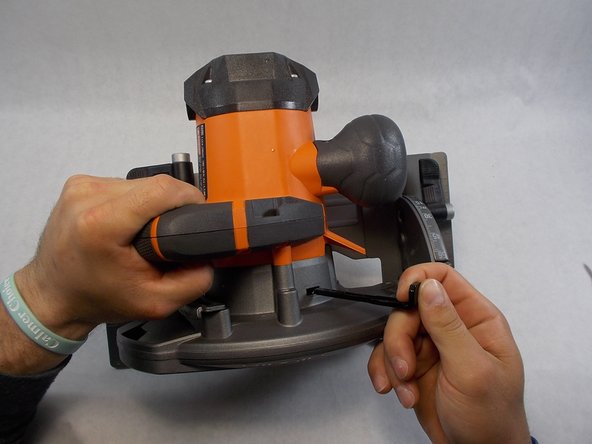

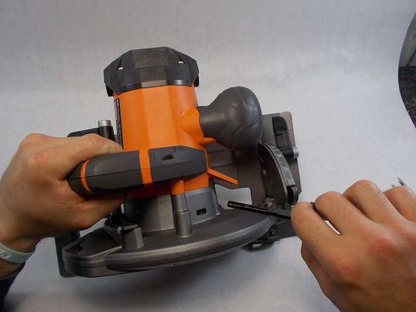

    • Press the black spindle lock and hold it down.
    • While keeping the spindle lock pressed down use a 6mm allen wrench to remove the 5/16-18 x 0.55 inch screw.

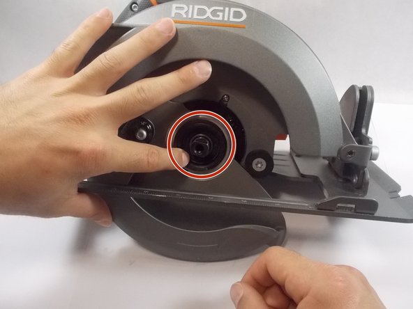

  2. Ridgid Circular Saw R3205 Spindle Lock Replacement: crwdns2935265:02crwdnd2935265:01crwdnd2935265:01crwdne2935265:0
    • Release the spindle lock and remove the outer flange by lifting it off the output shaft.

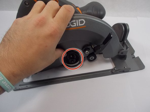

  3. Ridgid Circular Saw R3205 Spindle Lock Replacement: crwdns2935265:03crwdnd2935265:01crwdnd2935265:03crwdne2935265:0 Ridgid Circular Saw R3205 Spindle Lock Replacement: crwdns2935265:03crwdnd2935265:02crwdnd2935265:03crwdne2935265:0 Ridgid Circular Saw R3205 Spindle Lock Replacement: crwdns2935265:03crwdnd2935265:03crwdnd2935265:03crwdne2935265:0
    • With the outer flange removed retract the lower blade guard into the upper blade guard housing by pushing on the black lever.
    • Slide the blade out of from the bottom of the saw.

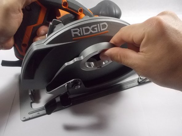

  4. Ridgid Circular Saw R3205 Spindle Lock Replacement, Lower Blade Guard: crwdns2935265:04crwdnd2935265:01crwdnd2935265:02crwdne2935265:0 Ridgid Circular Saw R3205 Spindle Lock Replacement, Lower Blade Guard: crwdns2935265:04crwdnd2935265:02crwdnd2935265:02crwdne2935265:0
    • Use a prying tool or your fingers to remove the inner flange.
