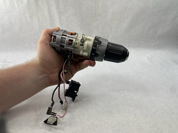

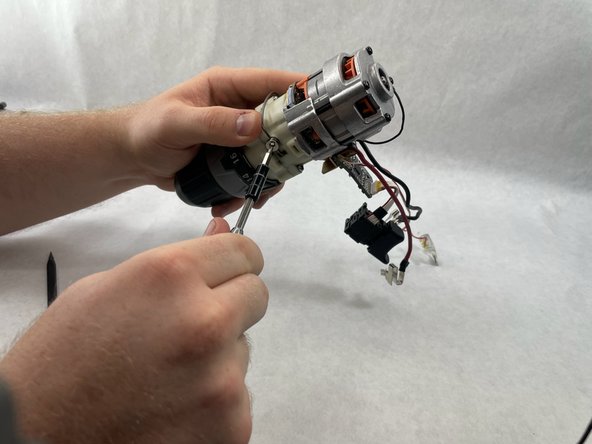

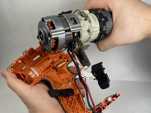

    • Using a T10 Torx security bit, remove the ten screws from the housing assembly.
    • All of the casing screws are the same length and require the same bit.
  2. Ridgid Brushless Drill Driver R860054 Speed Switch Replacement: crwdns2935265:02crwdnd2935265:01crwdnd2935265:02crwdne2935265:0 Ridgid Brushless Drill Driver R860054 Speed Switch Replacement: crwdns2935265:02crwdnd2935265:02crwdnd2935265:02crwdne2935265:0
    • Separate one half of the drill casing from the other by gently pulling both halves apart.
    • Once one half of the casing is removed, be careful! If the components are directed towards the ground, they could fall out.
  3. Ridgid Brushless Drill Driver R860054 Speed Switch Replacement: crwdns2935265:03crwdnd2935265:01crwdnd2935265:03crwdne2935265:0 Ridgid Brushless Drill Driver R860054 Speed Switch Replacement: crwdns2935265:03crwdnd2935265:02crwdnd2935265:03crwdne2935265:0 Ridgid Brushless Drill Driver R860054 Speed Switch Replacement: crwdns2935265:03crwdnd2935265:03crwdnd2935265:03crwdne2935265:0
    • Remove the plastic speed switch and forward/reverse switch by softly lifting them from the casing.
    • Remove the internal components of the drill by lightly pulling on the drill chuck.
    • All of the other electronic components are attached to the chuck, and will come out with it.

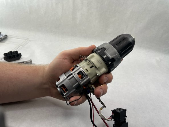

  4. Ridgid Brushless Drill Driver R860054 Speed Switch Replacement: crwdns2935265:04crwdnd2935265:01crwdnd2935265:01crwdne2935265:0
    • The main section of the drill should have the trigger, light indicator, and battery prongs all connected via wire. There should be two plastic switches separated from the rest of the body.

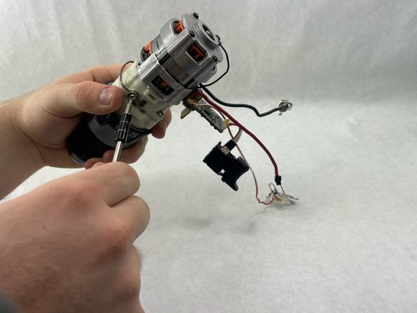

  5. Ridgid Brushless Drill Driver R860054 Speed Switch Replacement, Speed Selector Switch: crwdns2935265:05crwdnd2935265:01crwdnd2935265:03crwdne2935265:0 Ridgid Brushless Drill Driver R860054 Speed Switch Replacement, Speed Selector Switch: crwdns2935265:05crwdnd2935265:02crwdnd2935265:03crwdne2935265:0 Ridgid Brushless Drill Driver R860054 Speed Switch Replacement, Speed Selector Switch: crwdns2935265:05crwdnd2935265:03crwdnd2935265:03crwdne2935265:0

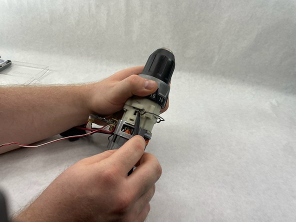

    • Using a T10 Torx security bit, remove the screws located on the left and right side of drill.

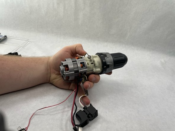

  6. Ridgid Brushless Drill Driver R860054 Speed Switch Replacement: crwdns2935265:06crwdnd2935265:01crwdnd2935265:03crwdne2935265:0 Ridgid Brushless Drill Driver R860054 Speed Switch Replacement: crwdns2935265:06crwdnd2935265:02crwdnd2935265:03crwdne2935265:0 Ridgid Brushless Drill Driver R860054 Speed Switch Replacement: crwdns2935265:06crwdnd2935265:03crwdnd2935265:03crwdne2935265:0
    • Remove the metal switch from the drill body on both the right side and left side using a pry tool.
  7. Ridgid Brushless Drill Driver R860054 Speed Switch Replacement: crwdns2935265:07crwdnd2935265:01crwdnd2935265:03crwdne2935265:0 Ridgid Brushless Drill Driver R860054 Speed Switch Replacement: crwdns2935265:07crwdnd2935265:02crwdnd2935265:03crwdne2935265:0 Ridgid Brushless Drill Driver R860054 Speed Switch Replacement: crwdns2935265:07crwdnd2935265:03crwdnd2935265:03crwdne2935265:0
    • Remove the metal arm from the drill body.
    • Insert and screw the new metal arm in the same place as the old metal arm.
