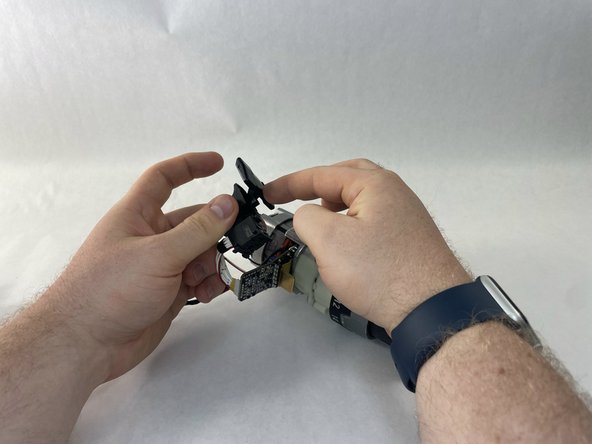

  4. Ridgid Brushless Drill Driver R860054 Reverse and Forward Switch Replacement: crwdns2935265:04crwdnd2935265:01crwdnd2935265:01crwdne2935265:0
    • The main section of the drill should have the trigger, light indicator, and battery prongs all connected via wire. There should be two plastic switches separated from the rest of the body.
  5. Ridgid Brushless Drill Driver R860054 Reverse and Forward Switch Replacement, Reverse and Forward Switch: crwdns2935265:05crwdnd2935265:01crwdnd2935265:02crwdne2935265:0 Ridgid Brushless Drill Driver R860054 Reverse and Forward Switch Replacement, Reverse and Forward Switch: crwdns2935265:05crwdnd2935265:02crwdnd2935265:02crwdne2935265:0
    • Remove the broken forward and backward switch by lifting it off of the trigger.
  6. Ridgid Brushless Drill Driver R860054 Reverse and Forward Switch Replacement: crwdns2935265:06crwdnd2935265:01crwdnd2935265:02crwdne2935265:0 Ridgid Brushless Drill Driver R860054 Reverse and Forward Switch Replacement: crwdns2935265:06crwdnd2935265:02crwdnd2935265:02crwdne2935265:0
    • Replace the reverse switch with a new a switch.
    • Ensure the switch is inserted properly.
