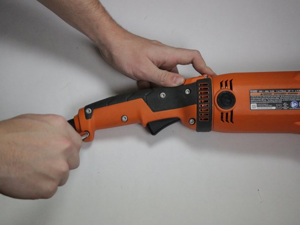

  4. Ridgid Angle Grinder R10202 Wiring Assembly Replacement: crwdns2935265:04crwdnd2935265:01crwdnd2935265:03crwdne2935265:0 Ridgid Angle Grinder R10202 Wiring Assembly Replacement: crwdns2935265:04crwdnd2935265:02crwdnd2935265:03crwdne2935265:0 Ridgid Angle Grinder R10202 Wiring Assembly Replacement: crwdns2935265:04crwdnd2935265:03crwdnd2935265:03crwdne2935265:0
    • Use TORX T20 Screwdriver to unscrew and remove 5 M5 x 16 mm, TORX Screws [28].
    • Use TORX T20 Screwdriver to unscrew and remove 1 M5 x 28 mm, TORX Screw [1].
    • Use TORX T10 Screwdriver to unscrew and remove 1 M3 x 10 mm Screw [26].

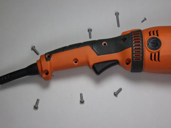

  5. Ridgid Angle Grinder R10202 Wiring Assembly Replacement: crwdns2935265:05crwdnd2935265:01crwdnd2935265:02crwdne2935265:0 Ridgid Angle Grinder R10202 Wiring Assembly Replacement: crwdns2935265:05crwdnd2935265:02crwdnd2935265:02crwdne2935265:0

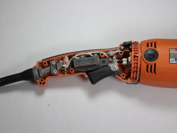

    • You should now be able to separate each side of the Handle Assembly [27] as seen in the first photograph.
    • Remove the side that should easily separate from the other.
    • One side will remain as seen in the second picture as it is still screwed in.

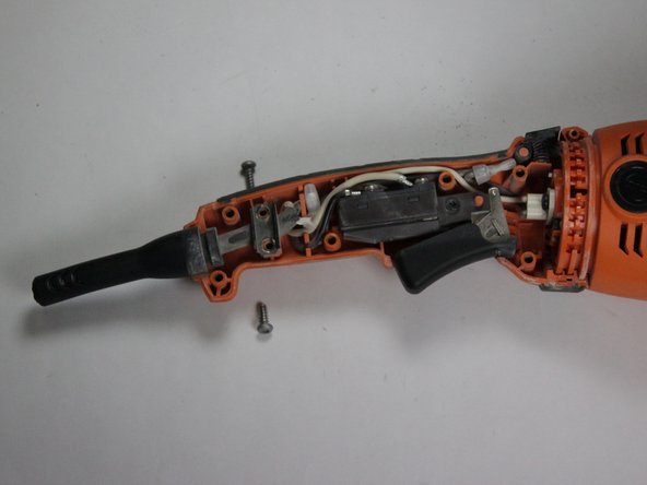

  6. Ridgid Angle Grinder R10202 Wiring Assembly Replacement: crwdns2935265:06crwdnd2935265:01crwdnd2935265:03crwdne2935265:0 Ridgid Angle Grinder R10202 Wiring Assembly Replacement: crwdns2935265:06crwdnd2935265:02crwdnd2935265:03crwdne2935265:0 Ridgid Angle Grinder R10202 Wiring Assembly Replacement: crwdns2935265:06crwdnd2935265:03crwdnd2935265:03crwdne2935265:0
    • Use a Hex Screwdriver to unscrew and remove the 2 8-16 x 1/2 in. Screws [29].

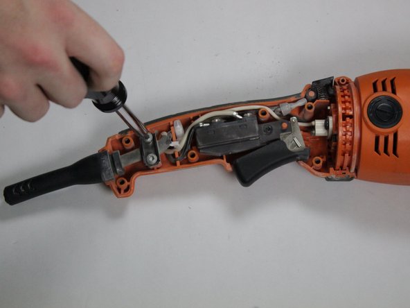

    • Use a screwdriver to unscrew and remove 1 M4 x 14 mm Screw [23].
  9. Ridgid Angle Grinder R10202 Wiring Assembly Replacement: crwdns2935265:09crwdnd2935265:01crwdnd2935265:03crwdne2935265:0 Ridgid Angle Grinder R10202 Wiring Assembly Replacement: crwdns2935265:09crwdnd2935265:02crwdnd2935265:03crwdne2935265:0 Ridgid Angle Grinder R10202 Wiring Assembly Replacement: crwdns2935265:09crwdnd2935265:03crwdnd2935265:03crwdne2935265:0

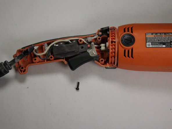

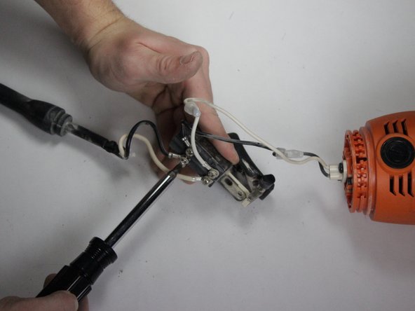

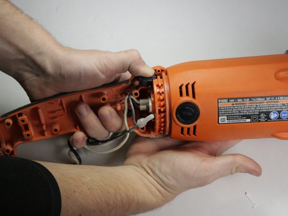

    • The whole wiring assembly should be able to be lifted out of where it currently is as seen in the first photograph.
    • Allow the wiring assembly to hang from the grinder as seen in the second picture.
    • Press and hold the Handle Lock Button [24] to release the second side of the Handle Assembly [27].

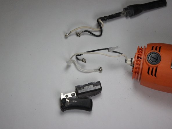

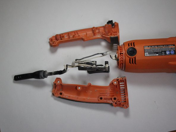

  10. Ridgid Angle Grinder R10202 Wiring Assembly Replacement: crwdns2935265:010crwdnd2935265:01crwdnd2935265:03crwdne2935265:0 Ridgid Angle Grinder R10202 Wiring Assembly Replacement: crwdns2935265:010crwdnd2935265:02crwdnd2935265:03crwdne2935265:0 Ridgid Angle Grinder R10202 Wiring Assembly Replacement: crwdns2935265:010crwdnd2935265:03crwdnd2935265:03crwdne2935265:0
    • Use screwdriver to unscrew 4 M3.5 x 7 mm Screws [22].
    • The Switch [21], Power Cord [32], and Motor Housing [11] should now all be separated as seen in the third photograph.
