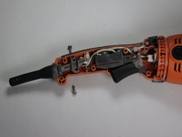

  4. Ridgid Angle Grinder R10202 Power Trigger Replacement: crwdns2935265:04crwdnd2935265:01crwdnd2935265:03crwdne2935265:0 Ridgid Angle Grinder R10202 Power Trigger Replacement: crwdns2935265:04crwdnd2935265:02crwdnd2935265:03crwdne2935265:0 Ridgid Angle Grinder R10202 Power Trigger Replacement: crwdns2935265:04crwdnd2935265:03crwdnd2935265:03crwdne2935265:0
    • Using a hex head screwdriver, remove the two 8-16 x 1/2in screws.

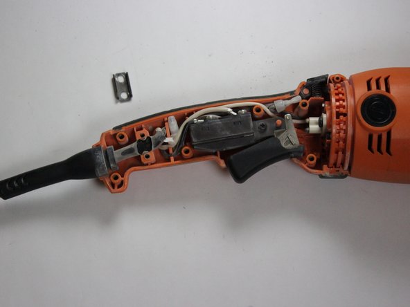

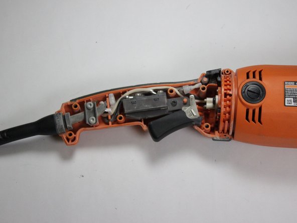

  5. Ridgid Angle Grinder R10202 Power Trigger Replacement: crwdns2935265:05crwdnd2935265:01crwdnd2935265:01crwdne2935265:0
    • Gently pull away the bend relief.
  6. Ridgid Angle Grinder R10202 Power Trigger Replacement: crwdns2935265:06crwdnd2935265:01crwdnd2935265:02crwdne2935265:0 Ridgid Angle Grinder R10202 Power Trigger Replacement: crwdns2935265:06crwdnd2935265:02crwdnd2935265:02crwdne2935265:0
    • Remove the one M4 x 14 mm screw using a Phillips screwdriver.

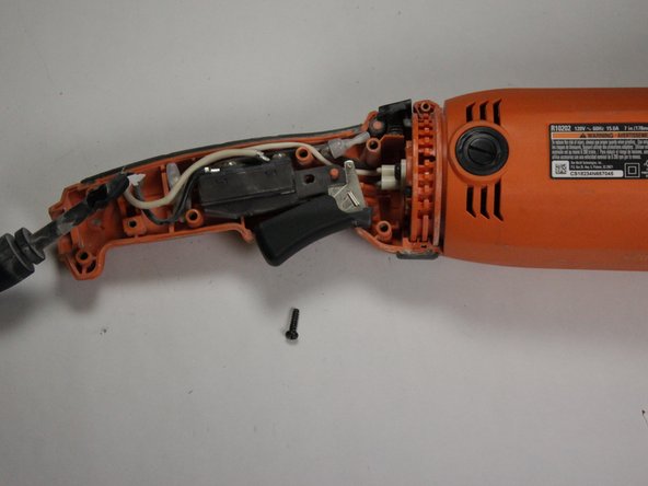

  7. Ridgid Angle Grinder R10202 Power Trigger Replacement: crwdns2935265:07crwdnd2935265:01crwdnd2935265:01crwdne2935265:0
    • Gently lift away the switch and wires.

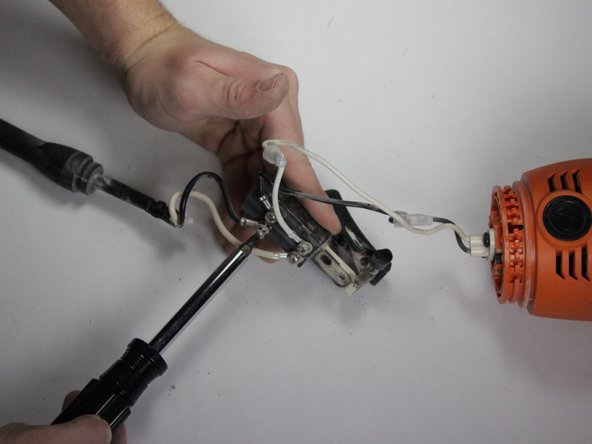

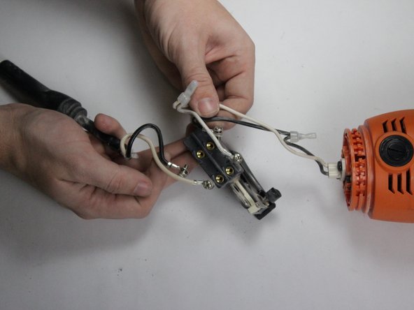

  9. Ridgid Angle Grinder R10202 Power Trigger Replacement, Power Trigger: crwdns2935265:09crwdnd2935265:01crwdnd2935265:03crwdne2935265:0 Ridgid Angle Grinder R10202 Power Trigger Replacement, Power Trigger: crwdns2935265:09crwdnd2935265:02crwdnd2935265:03crwdne2935265:0 Ridgid Angle Grinder R10202 Power Trigger Replacement, Power Trigger: crwdns2935265:09crwdnd2935265:03crwdnd2935265:03crwdne2935265:0
    • Using a bit driver, carefully remove the 4 M3.5 X 7mm holding the wires on.
    • Remember the order and position of each wire.
