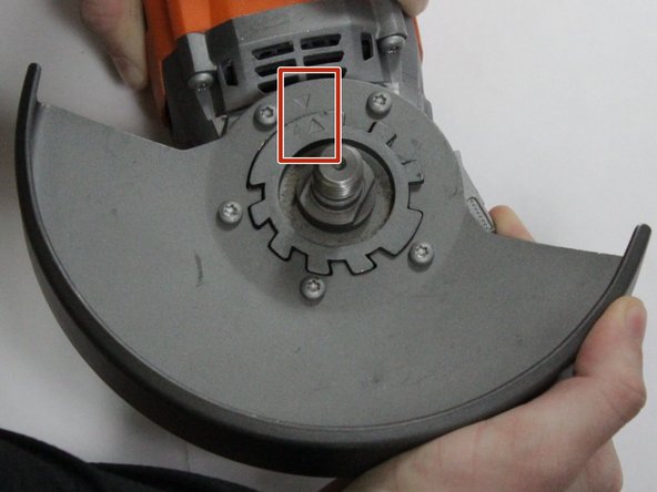

  5. Ridgid Angle Grinder R10202 Motor Housing Replacement: crwdns2935265:05crwdnd2935265:01crwdnd2935265:02crwdne2935265:0 Ridgid Angle Grinder R10202 Motor Housing Replacement: crwdns2935265:05crwdnd2935265:02crwdnd2935265:02crwdne2935265:0
    • Push in the guard lever and twist the guard until it aligns with the slots on the output shaft assembly.
    • There are two arrows that should align before you attempt to pull the pieces apart.

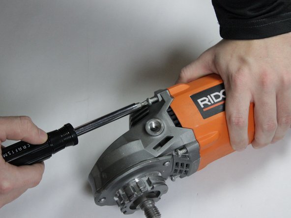

  7. Ridgid Angle Grinder R10202 Motor Housing Replacement: crwdns2935265:07crwdnd2935265:01crwdnd2935265:02crwdne2935265:0 Ridgid Angle Grinder R10202 Motor Housing Replacement: crwdns2935265:07crwdnd2935265:02crwdnd2935265:02crwdne2935265:0
    • Using a T25 Torx screwdriver, unscrew the four M5 X 28mm Torx screws.

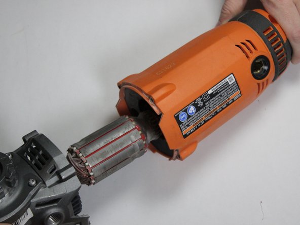

  8. Ridgid Angle Grinder R10202 Motor Housing Replacement: crwdns2935265:08crwdnd2935265:01crwdnd2935265:03crwdne2935265:0 Ridgid Angle Grinder R10202 Motor Housing Replacement: crwdns2935265:08crwdnd2935265:02crwdnd2935265:03crwdne2935265:0 Ridgid Angle Grinder R10202 Motor Housing Replacement: crwdns2935265:08crwdnd2935265:03crwdnd2935265:03crwdne2935265:0
    • Grab the handle assembly and the gear housing assembly and gently pull apart.
    • Slowly pull the gear housing assembly out being careful not to damage the motor against the inside of the motor housing.
