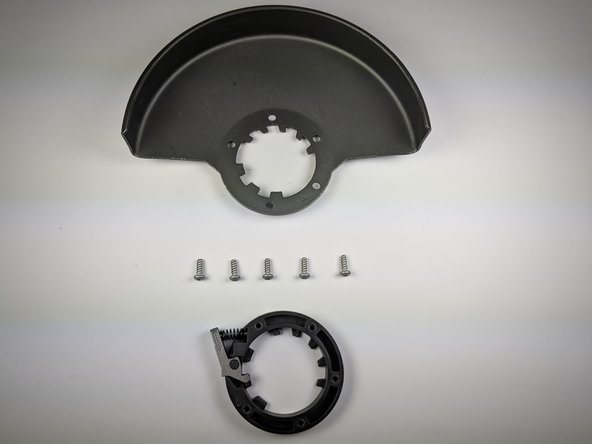

    • Unscrew the clamp nut and the backing flange from the output shaft assembly.
    • You can do this by hand or use a spanner wrench which should be provided in the manufacturers box.
  2. Ridgid Angle Grinder R10202 Disk Guard Spring Replacement: crwdns2935265:02crwdnd2935265:01crwdnd2935265:02crwdne2935265:0 Ridgid Angle Grinder R10202 Disk Guard Spring Replacement: crwdns2935265:02crwdnd2935265:02crwdnd2935265:02crwdne2935265:0
    • Push in the guard lever and twist the guard until it aligns with the slots on the output shaft assembly.
    • There are two arrows that should align before you attempt to pull the pieces apart.
  3. Ridgid Angle Grinder R10202 Disk Guard Spring Replacement: crwdns2935265:03crwdnd2935265:01crwdnd2935265:02crwdne2935265:0 Ridgid Angle Grinder R10202 Disk Guard Spring Replacement: crwdns2935265:03crwdnd2935265:02crwdnd2935265:02crwdne2935265:0
    • Unscrew the 5 M5 X 10mm screws using a Torx T20 Bit.
    • Carefully separate the spacer from the guard.
  4. Ridgid Angle Grinder R10202 Disk Guard Spring Replacement: crwdns2935265:04crwdnd2935265:01crwdnd2935265:02crwdne2935265:0 Ridgid Angle Grinder R10202 Disk Guard Spring Replacement: crwdns2935265:04crwdnd2935265:02crwdnd2935265:02crwdne2935265:0

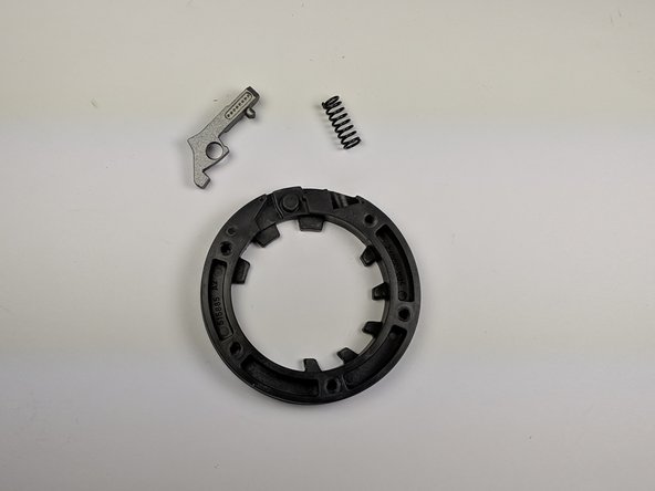

    • Gently push the spring away from the spacer.
    • The spacer, spring, and guard lever should now be all separate.
