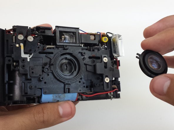

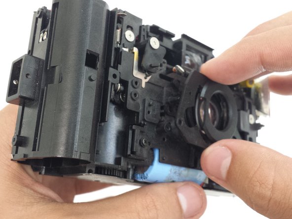

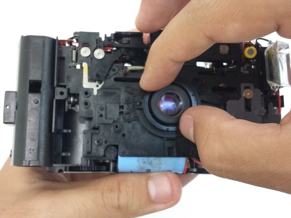

  7. Ricoh YF-20 Super Lens Replacement, Lens: crwdns2935265:07crwdnd2935265:01crwdnd2935265:03crwdne2935265:0 Ricoh YF-20 Super Lens Replacement, Lens: crwdns2935265:07crwdnd2935265:02crwdnd2935265:03crwdne2935265:0 Ricoh YF-20 Super Lens Replacement, Lens: crwdns2935265:07crwdnd2935265:03crwdnd2935265:03crwdne2935265:0
    • The lens is only attached to the main camera body. Set the front and back covers aside.
    • Unscrew three screws from the outermost plastic plate covering the lens.
    • After the screws are removed, the outermost plate can be removed.

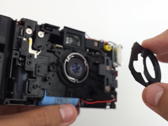

  8. Ricoh YF-20 Super Lens Replacement: crwdns2935265:08crwdnd2935265:01crwdnd2935265:03crwdne2935265:0 Ricoh YF-20 Super Lens Replacement: crwdns2935265:08crwdnd2935265:02crwdnd2935265:03crwdne2935265:0 Ricoh YF-20 Super Lens Replacement: crwdns2935265:08crwdnd2935265:03crwdnd2935265:03crwdne2935265:0
    • Remove the ring shaped metal brace.
    • Using fingers or tweezers, remove the lens from the camera.
