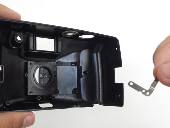

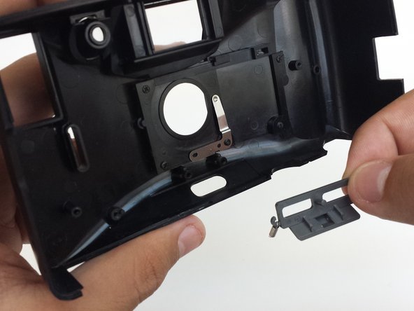

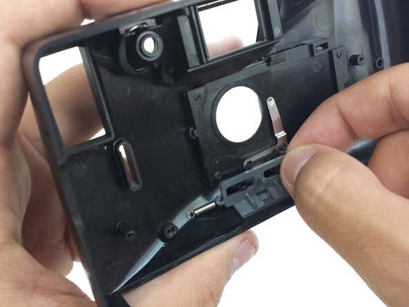

  8. Ricoh YF-20 Super Lens Cover Replacement: crwdns2935265:08crwdnd2935265:01crwdnd2935265:03crwdne2935265:0 Ricoh YF-20 Super Lens Cover Replacement: crwdns2935265:08crwdnd2935265:02crwdnd2935265:03crwdne2935265:0 Ricoh YF-20 Super Lens Cover Replacement: crwdns2935265:08crwdnd2935265:03crwdnd2935265:03crwdne2935265:0
    • Unscrew the five screws that hold the lens cover plate and metal brace in place.
    • Remove metal brace.
    • Remove lens cover plate.

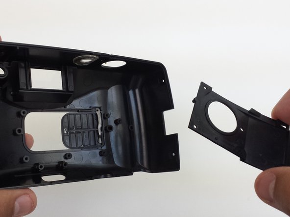

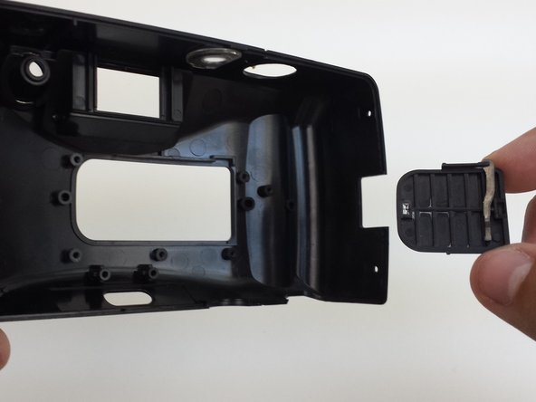

  9. Ricoh YF-20 Super Lens Cover Replacement: crwdns2935265:09crwdnd2935265:01crwdnd2935265:02crwdne2935265:0 Ricoh YF-20 Super Lens Cover Replacement: crwdns2935265:09crwdnd2935265:02crwdnd2935265:02crwdne2935265:0
    • To remove lens cover, push the lens cover from the outside of the front cover towards the inside of the front cover.
    • Remove the lens cover.
    • The metal arm attached to the lens cover is not securely attached and may fall off.
