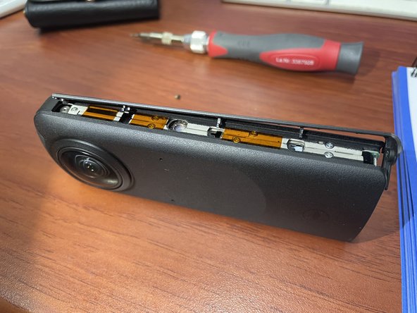

  6. Ricoh Theta Z1 Battery Replacement, Opening the Case: crwdns2935265:06crwdnd2935265:01crwdnd2935265:02crwdne2935265:0 Ricoh Theta Z1 Battery Replacement, Opening the Case: crwdns2935265:06crwdnd2935265:02crwdnd2935265:02crwdne2935265:0
    • Now one part of the case can be pulled away, carefully observing the pin for the strap holder.

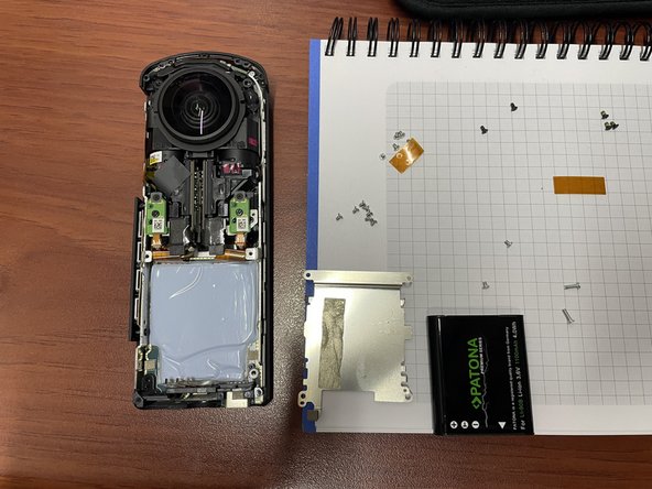

  7. Ricoh Theta Z1 Battery Replacement, Replacing the Battery: crwdns2935265:07crwdnd2935265:01crwdnd2935265:03crwdne2935265:0 Ricoh Theta Z1 Battery Replacement, Replacing the Battery: crwdns2935265:07crwdnd2935265:02crwdnd2935265:03crwdne2935265:0 Ricoh Theta Z1 Battery Replacement, Replacing the Battery: crwdns2935265:07crwdnd2935265:03crwdnd2935265:03crwdne2935265:0

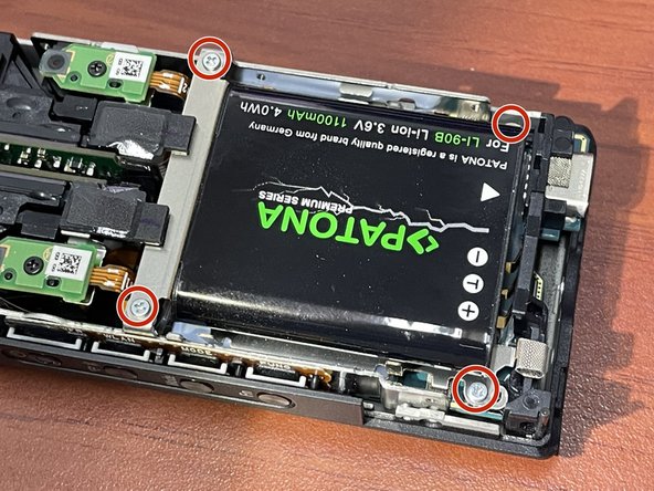

    • The battery is glued with tape to a holder, that has to be unscrewed.
