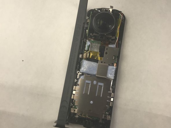

    • Carefully pull the side casing away from the camera.
  8. Ricoh Theta S Internal microSD Replacement: crwdns2935265:08crwdnd2935265:01crwdnd2935265:03crwdne2935265:0 Ricoh Theta S Internal microSD Replacement: crwdns2935265:08crwdnd2935265:02crwdnd2935265:03crwdne2935265:0 Ricoh Theta S Internal microSD Replacement: crwdns2935265:08crwdnd2935265:03crwdnd2935265:03crwdne2935265:0

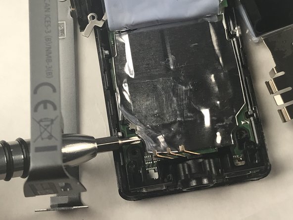

    • Lift up the plastic containing thermal compound to reveal the thermal tape covering the motherboard.
    • Peel back the lower left corner of the thermal tape to reveal the microSD slot located on the motherboard.

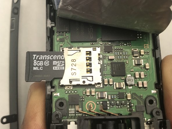

  9. Ricoh Theta S Internal microSD Replacement: crwdns2935265:09crwdnd2935265:01crwdnd2935265:02crwdne2935265:0 Ricoh Theta S Internal microSD Replacement: crwdns2935265:09crwdnd2935265:02crwdnd2935265:02crwdne2935265:0
    • Push the microSD card inward, from the side.
    • Once a click is heard, pull the screwdriver away to eject the microSD card from the slot.

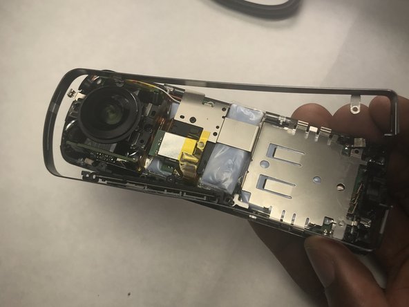

I was able to complete this however there is a clear plastic guard running around the bottom half of the Theta S, and the only way to get the SD Card above that guard was to remove a few additional screws. Fortunately was not that complex and reassembly was still successful. Good luck!

I successfully replaced my microSD card with a transcend 32gb card, and it’s working. Only thing is, I ended up with 2 tiny braided wire sleeves that fell out during the process, and I have no idea where they are supposed to be. Also, before the repair, I had, an error come up at random and stop interval shooting (while there was still space available and power):
_cameraError":[“FORMAT_CARD”]
Now, after the repair, the error is:
_cameraError":["FORMAT_INTERNAL_MEM"]
And it’s constant, but, aside from causing the red lamp to blink always, and also beeping when I turn it on, it doesn’t seem to affect the function of the camera.
One point to improve the tutorial would be in step 8, in the 3rd picture, there’s a metallic, odd shaped piece sitting at an angle in the picture. This piece fell out when I was working to replace the microSD card, and I had to search other tutorials to figure out where it had to go.
