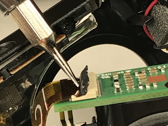

  6. Ricoh Theta S Camera Assembly Replacement: crwdns2935265:06crwdnd2935265:01crwdnd2935265:02crwdne2935265:0 Ricoh Theta S Camera Assembly Replacement: crwdns2935265:06crwdnd2935265:02crwdnd2935265:02crwdne2935265:0
    • Find the two ribbon cable connectors located on each side of the device.
    • Using a plastic spudger, gently lift the black plastic piece of the connector.
    • The images show a screwdriver being used to flip up the tabs of the ZIF connectors, which carries the possibility of shorting the motherboard. Be sure to use an ESD safe tool instead!
  7. Ricoh Theta S Camera Assembly Replacement: crwdns2935265:07crwdnd2935265:01crwdnd2935265:02crwdne2935265:0 Ricoh Theta S Camera Assembly Replacement: crwdns2935265:07crwdnd2935265:02crwdnd2935265:02crwdne2935265:0
    • Carefully detach the two ribbons cables from their connectors to remove the camera assembly.
