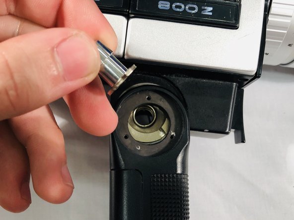

    • Using the Phillips #000 screwdriver, remove the three screws on the round plate on the right side of the camera handle. This is the side with the handle lock release button.
  3. Ricoh Super 8 800z Handle Assembly Replacement: crwdns2935265:03crwdnd2935265:01crwdnd2935265:03crwdne2935265:0 Ricoh Super 8 800z Handle Assembly Replacement: crwdns2935265:03crwdnd2935265:02crwdnd2935265:03crwdne2935265:0 Ricoh Super 8 800z Handle Assembly Replacement: crwdns2935265:03crwdnd2935265:03crwdnd2935265:03crwdne2935265:0
    • Remove the round metal plate.
    • Then, shift the handle so you have clearance to pass one of the legs of the button through the opening.
  4. Ricoh Super 8 800z Handle Assembly Replacement: crwdns2935265:04crwdnd2935265:01crwdnd2935265:03crwdne2935265:0 Ricoh Super 8 800z Handle Assembly Replacement: crwdns2935265:04crwdnd2935265:02crwdnd2935265:03crwdne2935265:0 Ricoh Super 8 800z Handle Assembly Replacement: crwdns2935265:04crwdnd2935265:03crwdnd2935265:03crwdne2935265:0
    • Pull the button out at an angle.
    • Remove the spring beneath it with a pair of tweezers.

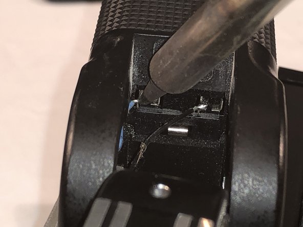

  6. Ricoh Super 8 800z Handle Assembly Replacement: crwdns2935265:06crwdnd2935265:01crwdnd2935265:03crwdne2935265:0 Ricoh Super 8 800z Handle Assembly Replacement: crwdns2935265:06crwdnd2935265:02crwdnd2935265:03crwdne2935265:0 Ricoh Super 8 800z Handle Assembly Replacement: crwdns2935265:06crwdnd2935265:03crwdnd2935265:03crwdne2935265:0
    • Pull the handle slowly away from the camera and shift the handle to allow access to the wire connections.
    • Desolder these wires carefully and you can now remove the handle.
