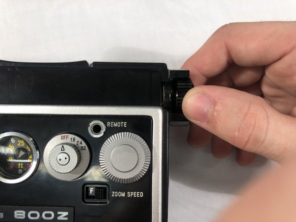

    • Turn the adjustment ring counter clockwise until it is as close to the lens as it will go.

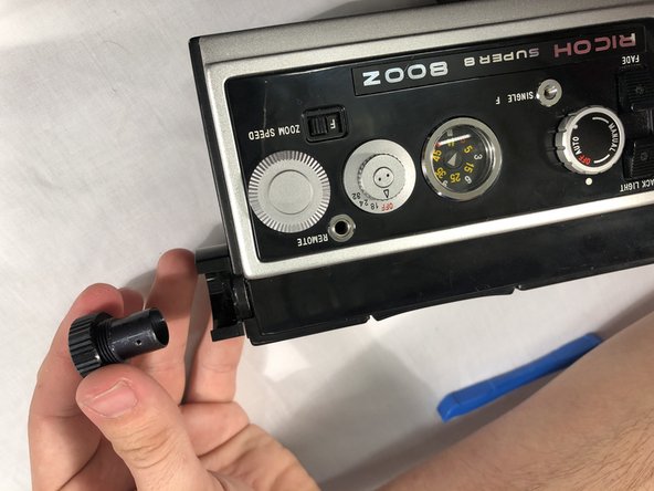

    • Use a #1 flathead screwdriver to remove screw in the oval opening beside the eyepiece. Be careful not to drop the screw into the camera body.
  6. Ricoh Super 8 800z Eyepiece Adjuster Replacement: crwdns2935265:06crwdnd2935265:01crwdnd2935265:03crwdne2935265:0 Ricoh Super 8 800z Eyepiece Adjuster Replacement: crwdns2935265:06crwdnd2935265:02crwdnd2935265:03crwdne2935265:0 Ricoh Super 8 800z Eyepiece Adjuster Replacement: crwdns2935265:06crwdnd2935265:03crwdnd2935265:03crwdne2935265:0

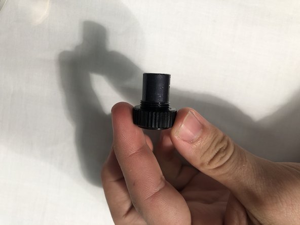

    • Slide the eyepiece adjuster out of the camera body.
