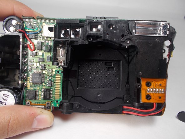

    • Remove the 5 Phillips screws from the sides and the back.

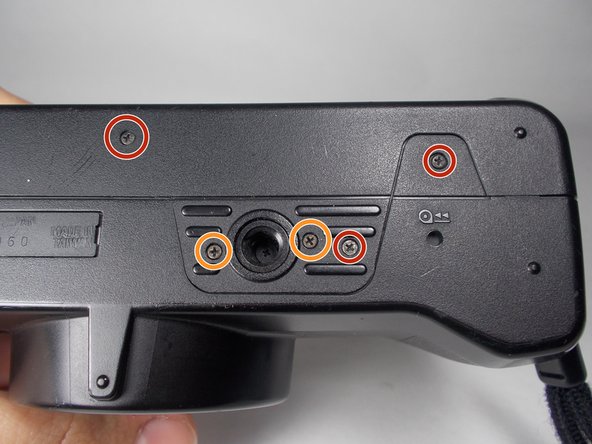

    • Remove the 5mm JIS #00 screws from the bottom of the camera.
    • Pay attention to the 6mm screws on the sides of the tripod slot, as they are a slightly different size from the rest of the screws. However, you still may use a J00 screwdriver to remove them.

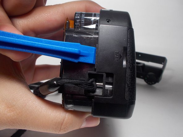

    • Using an opening tool, lift the case of the tripod slot (on the bottom) until the back portion of the case is released.
    • Continue to use the the opening tool to insert it and lift right next to the strap of the camera.
    • This will release the front portion of the case.

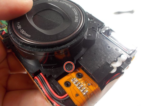

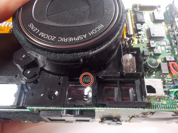

    • Use a JIS #0 screwdriver to remove the three marked screws found around the perimeter of the lens.

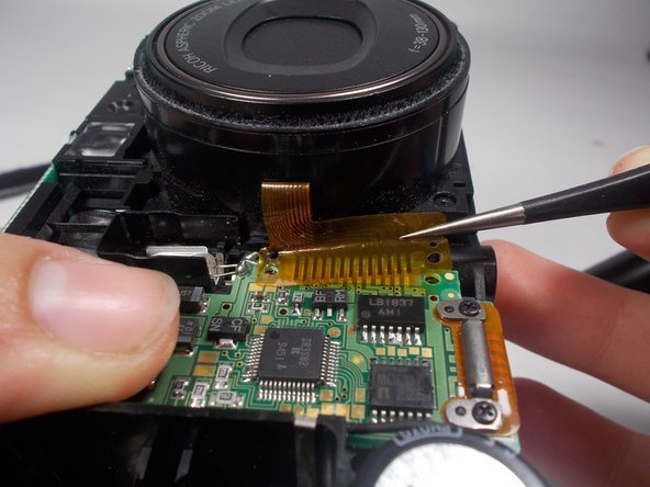

    • Proceed to remove the two screws using a JIS #00 screwdriver.
    • Use tweezers to lift the lens off of the board.
