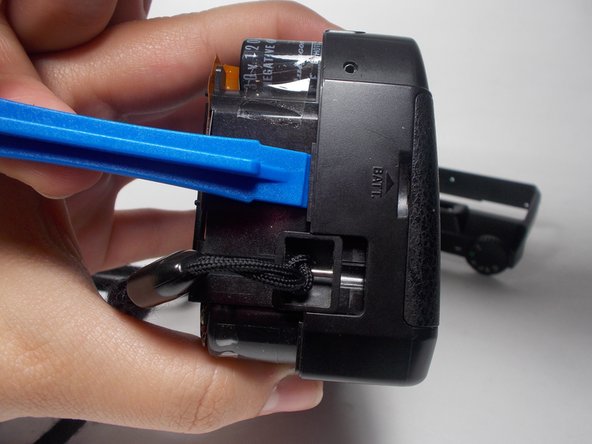

    • Using a blue opening tool start by lifting the back part of the case right where the tripod dip is. Lift until the back part of the case is released and can be easily removed
    • Next, using the same opening tool lift and push by the battery compartment as shown in the second picture. Do this until the front part of the case is released and can be easily removed.

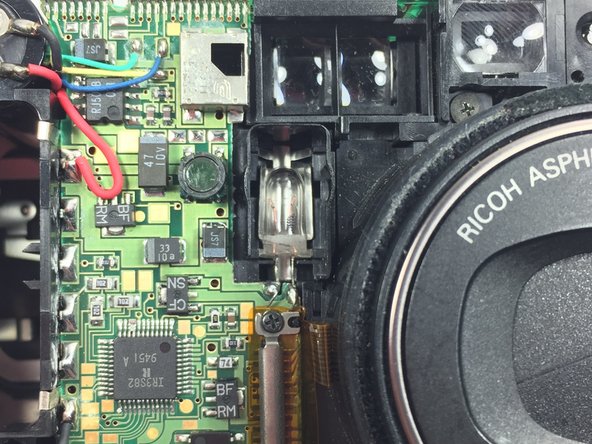

    • The LED diode to be replaced can be found in the front of the camera next to the zooming lens.
    • Desolder the LED to remove it from the motherboard
