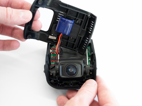

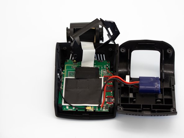

    • Begin by orienting the device with the LCD screen facing down.
    • Remove the four 6 mm screws, located on the backside of the device, using the Phillips #00 screwdriver.
  2. Rexing V1P Plus Screen Replacement: crwdns2935265:02crwdnd2935265:01crwdnd2935265:03crwdne2935265:0 Rexing V1P Plus Screen Replacement: crwdns2935265:02crwdnd2935265:02crwdnd2935265:03crwdne2935265:0 Rexing V1P Plus Screen Replacement: crwdns2935265:02crwdnd2935265:03crwdnd2935265:03crwdne2935265:0
    • Remove the back cover of the device and place it to the side.

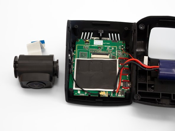

    • Rotate the device 180 degrees to where the camera is facing you.

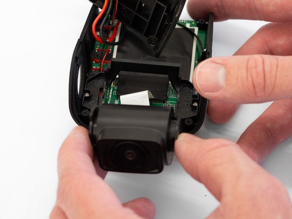

  3. Rexing V1P Plus Screen Replacement: crwdns2935265:03crwdnd2935265:01crwdnd2935265:03crwdne2935265:0 Rexing V1P Plus Screen Replacement: crwdns2935265:03crwdnd2935265:02crwdnd2935265:03crwdne2935265:0 Rexing V1P Plus Screen Replacement: crwdns2935265:03crwdnd2935265:03crwdnd2935265:03crwdne2935265:0
    • Remove the two 5 mm screws next to the lens using the Phillips #00 screwdriver.

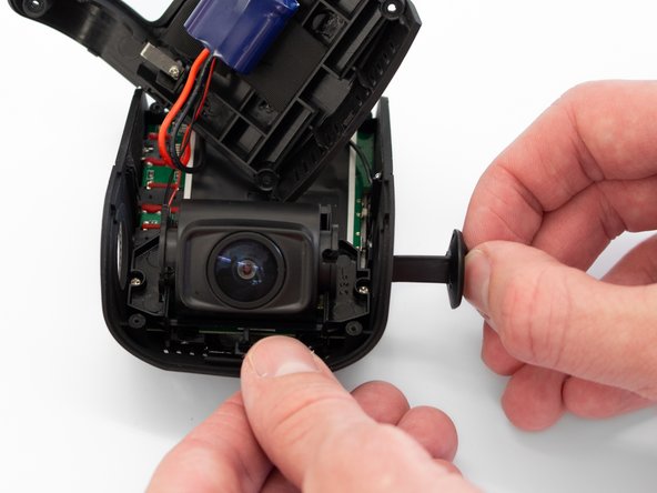

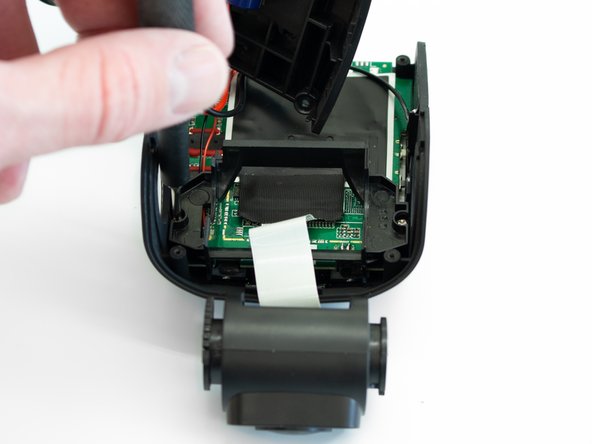

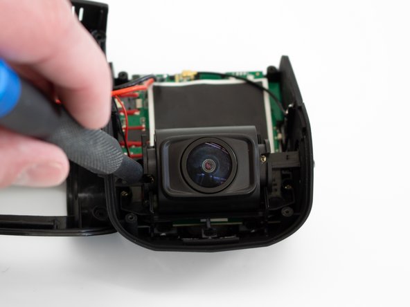

  4. Rexing V1P Plus Screen Replacement: crwdns2935265:04crwdnd2935265:01crwdnd2935265:03crwdne2935265:0 Rexing V1P Plus Screen Replacement: crwdns2935265:04crwdnd2935265:02crwdnd2935265:03crwdne2935265:0 Rexing V1P Plus Screen Replacement: crwdns2935265:04crwdnd2935265:03crwdnd2935265:03crwdne2935265:0
    • Remove the two camera angle adjusters from the side of the device and carefully pull out the lens.
  5. Rexing V1P Plus Screen Replacement: crwdns2935265:05crwdnd2935265:01crwdnd2935265:03crwdne2935265:0 Rexing V1P Plus Screen Replacement: crwdns2935265:05crwdnd2935265:02crwdnd2935265:03crwdne2935265:0 Rexing V1P Plus Screen Replacement: crwdns2935265:05crwdnd2935265:03crwdnd2935265:03crwdne2935265:0
    • Remove the two 5mm screws securing the camera support bracket using the Phillips #00 screwdriver.

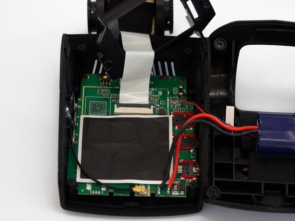

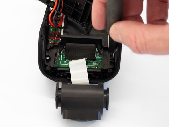

  6. Rexing V1P Plus Screen Replacement: crwdns2935265:06crwdnd2935265:01crwdnd2935265:03crwdne2935265:0 Rexing V1P Plus Screen Replacement: crwdns2935265:06crwdnd2935265:02crwdnd2935265:03crwdne2935265:0 Rexing V1P Plus Screen Replacement: crwdns2935265:06crwdnd2935265:03crwdnd2935265:03crwdne2935265:0

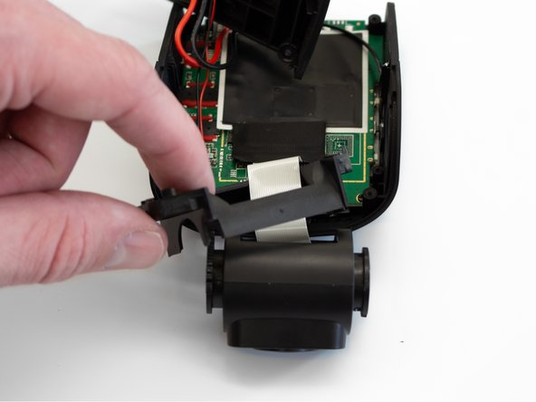

    • Carefully remove the plastic frame piece from its previously secured position on the motherboard.
    • It will rest loosely around the white camera ribbon.
    • Rotate the device 180 degrees to where the camera is facing away from you.

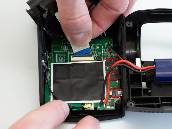

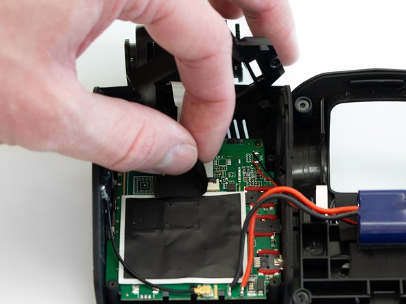

  7. Rexing V1P Plus Screen Replacement: crwdns2935265:07crwdnd2935265:01crwdnd2935265:03crwdne2935265:0 Rexing V1P Plus Screen Replacement: crwdns2935265:07crwdnd2935265:02crwdnd2935265:03crwdne2935265:0 Rexing V1P Plus Screen Replacement: crwdns2935265:07crwdnd2935265:03crwdnd2935265:03crwdne2935265:0
    • Carefully peel back the adhesive material covering the ribbon cable connection.
  8. Rexing V1P Plus Screen Replacement: crwdns2935265:08crwdnd2935265:01crwdnd2935265:03crwdne2935265:0 Rexing V1P Plus Screen Replacement: crwdns2935265:08crwdnd2935265:02crwdnd2935265:03crwdne2935265:0 Rexing V1P Plus Screen Replacement: crwdns2935265:08crwdnd2935265:03crwdnd2935265:03crwdne2935265:0
    • Using the Flathead 1.5mm screwdriver, or another pry tool, gently flip up the black ZIF connector locking flap to free the ribbon cable.
    • Once the connector is open, slide the ribbon cable out to remove it.

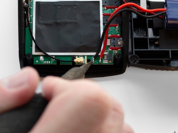

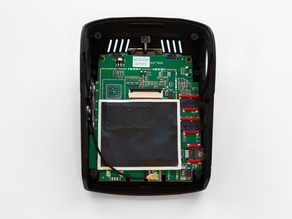

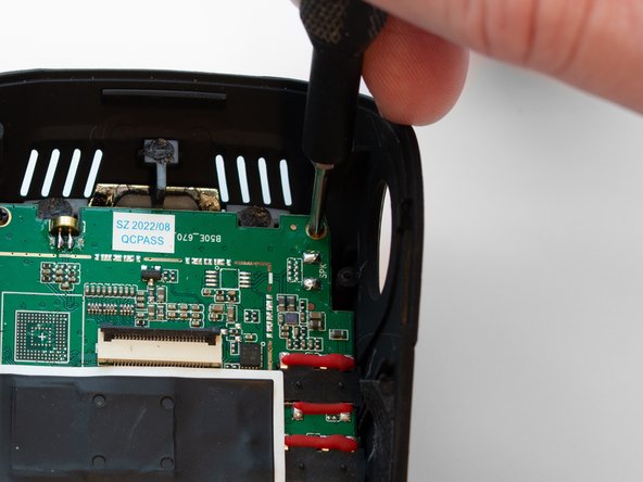

  9. Rexing V1P Plus Screen Replacement, Motherboard: crwdns2935265:09crwdnd2935265:01crwdnd2935265:03crwdne2935265:0 Rexing V1P Plus Screen Replacement, Motherboard: crwdns2935265:09crwdnd2935265:02crwdnd2935265:03crwdne2935265:0 Rexing V1P Plus Screen Replacement, Motherboard: crwdns2935265:09crwdnd2935265:03crwdnd2935265:03crwdne2935265:0
    • Using a soldering iron, disconnect the four wires connected to the motherboard.
  10. Rexing V1P Plus Screen Replacement: crwdns2935265:010crwdnd2935265:01crwdnd2935265:03crwdne2935265:0 Rexing V1P Plus Screen Replacement: crwdns2935265:010crwdnd2935265:02crwdnd2935265:03crwdne2935265:0 Rexing V1P Plus Screen Replacement: crwdns2935265:010crwdnd2935265:03crwdnd2935265:03crwdne2935265:0
    • Using the Phillips #00 screwdriver, remove the three 3.5 mm screws securing the motherboard to the case.

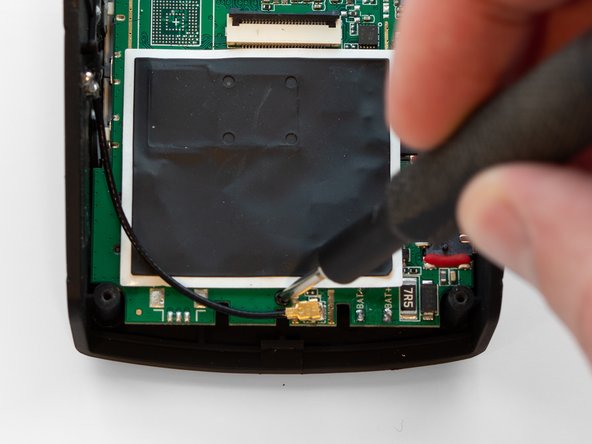

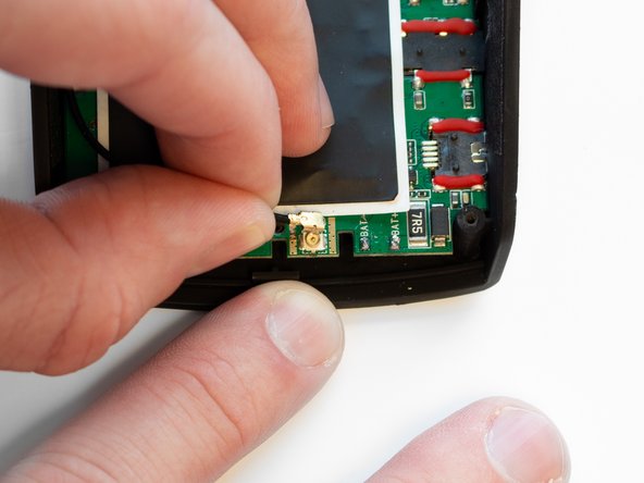

  11. Rexing V1P Plus Screen Replacement: crwdns2935265:011crwdnd2935265:01crwdnd2935265:03crwdne2935265:0 Rexing V1P Plus Screen Replacement: crwdns2935265:011crwdnd2935265:02crwdnd2935265:03crwdne2935265:0 Rexing V1P Plus Screen Replacement: crwdns2935265:011crwdnd2935265:03crwdnd2935265:03crwdne2935265:0

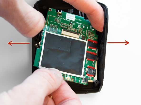

    • Pull the black antenna wire with the gold cap straight up to disconnect it from the motherboard.
    • Using your fingers, spread the case apart to provide space for the motherboard to be removed.
    • This must be done to free the connected ports from their mounting locations in the case.

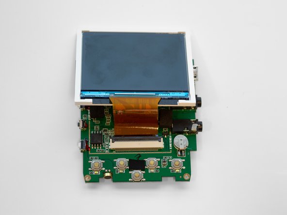

  12. Rexing V1P Plus Screen Replacement, Screen: crwdns2935265:012crwdnd2935265:01crwdnd2935265:02crwdne2935265:0 Rexing V1P Plus Screen Replacement, Screen: crwdns2935265:012crwdnd2935265:02crwdnd2935265:02crwdne2935265:0
    • Once separated from the case, flip the motherboard over so the screen faces upward.
    • Rotate the motherboard so that the screen hangs over the top of the motherboard, as seen in the second image.

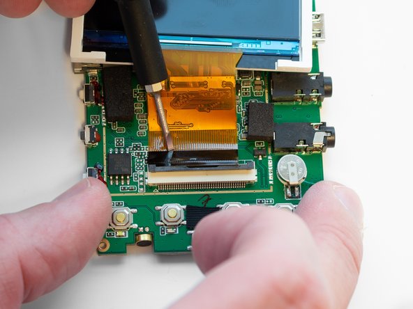

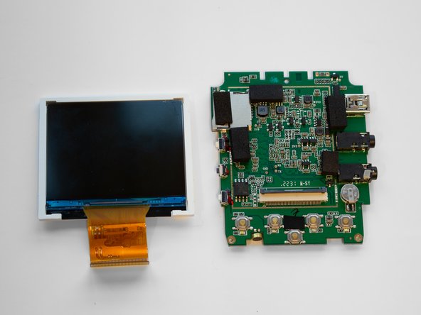

  13. Rexing V1P Plus Screen Replacement: crwdns2935265:013crwdnd2935265:01crwdnd2935265:03crwdne2935265:0 Rexing V1P Plus Screen Replacement: crwdns2935265:013crwdnd2935265:02crwdnd2935265:03crwdne2935265:0 Rexing V1P Plus Screen Replacement: crwdns2935265:013crwdnd2935265:03crwdnd2935265:03crwdne2935265:0
    • Using the Flathead 1.5mm screwdriver, flip up the black ZIF connector locking flap to free the ribbon cable.
    • Slide the ribbon cable out to remove it.
