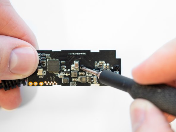

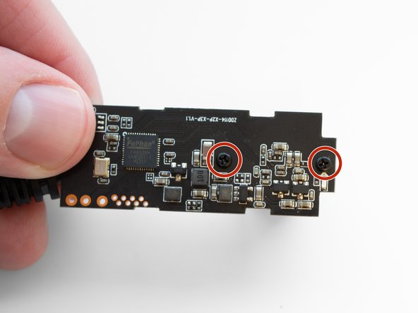

    • Remove the camera and camera motherboard from the casing.
    • Flip the camera board over revealing the two 3.5 mm screws on the back holding the rear camera to the board.
  4. Rexing V1P Plus Rear Camera Replacement: crwdns2935265:04crwdnd2935265:01crwdnd2935265:03crwdne2935265:0 Rexing V1P Plus Rear Camera Replacement: crwdns2935265:04crwdnd2935265:02crwdnd2935265:03crwdne2935265:0 Rexing V1P Plus Rear Camera Replacement: crwdns2935265:04crwdnd2935265:03crwdnd2935265:03crwdne2935265:0

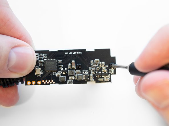

    • Remove the two 3.5 mm screws securing the camera to the motherboard using the Phillips #00 screwdriver.
  5. Rexing V1P Plus Rear Camera Replacement: crwdns2935265:05crwdnd2935265:01crwdnd2935265:01crwdne2935265:0
    • With the screws removed, the rear camera can be separated from the motherboard.
