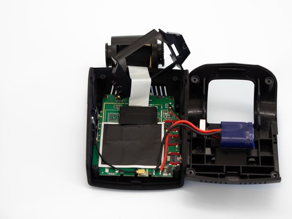

    • Orient the device with the LCD screen facing down.
    • Remove the four 6 mm screws, located on the backside of the device, using the Phillips #00 screwdriver.

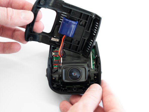

  2. Rexing V1P Plus Battery Replacement: crwdns2935265:02crwdnd2935265:01crwdnd2935265:03crwdne2935265:0 Rexing V1P Plus Battery Replacement: crwdns2935265:02crwdnd2935265:02crwdnd2935265:03crwdne2935265:0 Rexing V1P Plus Battery Replacement: crwdns2935265:02crwdnd2935265:03crwdnd2935265:03crwdne2935265:0
    • Remove the back cover of the device and place it to the side, with care not to strain the connected battery cable.
    • Rotate the device 180 degrees to where the camera is facing you.

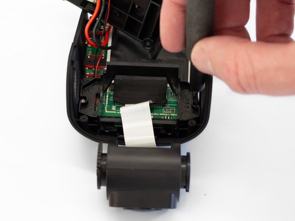

  3. Rexing V1P Plus Battery Replacement: crwdns2935265:03crwdnd2935265:01crwdnd2935265:03crwdne2935265:0 Rexing V1P Plus Battery Replacement: crwdns2935265:03crwdnd2935265:02crwdnd2935265:03crwdne2935265:0 Rexing V1P Plus Battery Replacement: crwdns2935265:03crwdnd2935265:03crwdnd2935265:03crwdne2935265:0

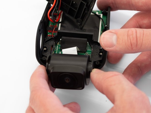

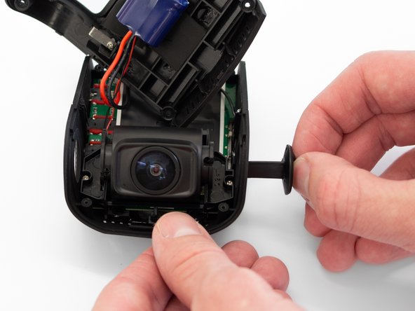

    • Remove the two 5 mm screws on either side of the lens using the Phillips #00 screwdriver.
  4. Rexing V1P Plus Battery Replacement: crwdns2935265:04crwdnd2935265:01crwdnd2935265:03crwdne2935265:0 Rexing V1P Plus Battery Replacement: crwdns2935265:04crwdnd2935265:02crwdnd2935265:03crwdne2935265:0 Rexing V1P Plus Battery Replacement: crwdns2935265:04crwdnd2935265:03crwdnd2935265:03crwdne2935265:0
    • Remove the two camera angle adjusters from the side of the device and carefully pull out the lens.

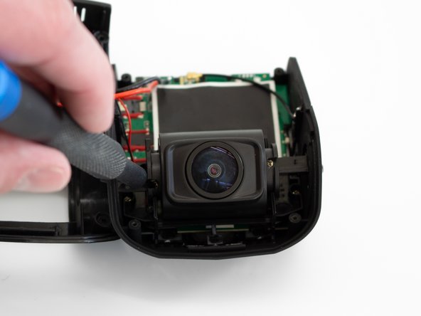

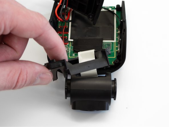

  5. Rexing V1P Plus Battery Replacement: crwdns2935265:05crwdnd2935265:01crwdnd2935265:03crwdne2935265:0 Rexing V1P Plus Battery Replacement: crwdns2935265:05crwdnd2935265:02crwdnd2935265:03crwdne2935265:0 Rexing V1P Plus Battery Replacement: crwdns2935265:05crwdnd2935265:03crwdnd2935265:03crwdne2935265:0
    • Remove the two 5 mm screws securing the camera support bracket using the Phillips #00 screwdriver.

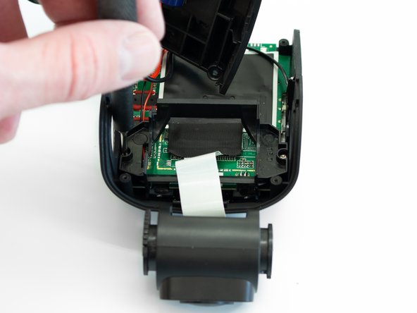

  6. Rexing V1P Plus Battery Replacement: crwdns2935265:06crwdnd2935265:01crwdnd2935265:03crwdne2935265:0 Rexing V1P Plus Battery Replacement: crwdns2935265:06crwdnd2935265:02crwdnd2935265:03crwdne2935265:0 Rexing V1P Plus Battery Replacement: crwdns2935265:06crwdnd2935265:03crwdnd2935265:03crwdne2935265:0
    • Carefully remove the plastic frame from its previously secured position on the motherboard.
    • It will rest loosely around the white camera ribbon.
    • Rotate the device 180 degrees to where the camera is facing away from you.

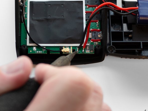

  7. Rexing V1P Plus Battery Replacement: crwdns2935265:07crwdnd2935265:01crwdnd2935265:03crwdne2935265:0 Rexing V1P Plus Battery Replacement: crwdns2935265:07crwdnd2935265:02crwdnd2935265:03crwdne2935265:0 Rexing V1P Plus Battery Replacement: crwdns2935265:07crwdnd2935265:03crwdnd2935265:03crwdne2935265:0
    • Using a soldering iron, remove the two wires connecting the battery to the motherboard.
    • Soldering has the potential to burn you or damage your device. Check out this guide before beginning, take appropriate precautions, and always solder in a well-ventilated area.
    • Once the wires are removed, peel the battery off of the case adhesive.

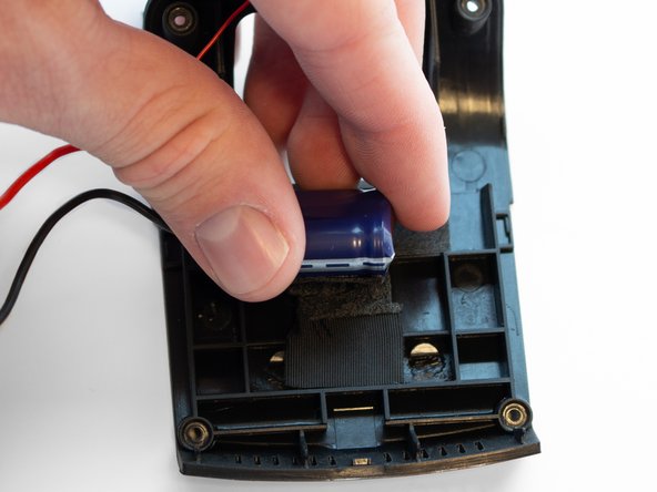

Where is it possible to get the replacement battery? Searching on ebay reveals nothing for the information given.
Derek Piper - crwdns2934203:0crwdne2934203:0 crwdns2950251:0crwdne2950251:0
Did you find the replacement capacitors?
Jesse Wamberg - crwdns2934203:0crwdne2934203:0 crwdns2950251:0crwdne2950251:0
Just realized this appears to be what is known as a 'super capacitor' rather than a battery so it's possible any 5.5V 3.5Farad capacitor will work. The form factor may be an issue though.
Replaced the capacitor and it lasts longer but will still lose date and time over night, so probably another component went bad causing drain. Shame.
