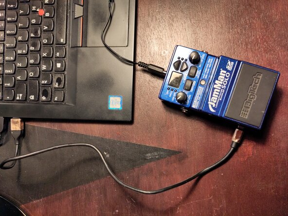

    • Before starting, plug your pedal to a computer using an USB mini B cable.
    • If your device is detected (for instance in Peripheral Manager for Windows users, with "lsusb" for Linux users)
    • Install the JamManager software from here
    • Try updating the firmware using JamManager
    • If your device is not detected, or if the firmware update fails, carry on with this tutorial

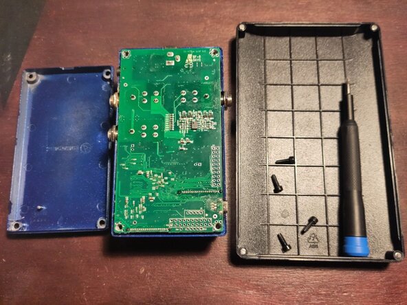

  2. Rewriting corrupted firmware on Digitech JamMan Solo, Open the pedal: crwdns2935265:02crwdnd2935265:01crwdnd2935265:02crwdne2935265:0 Rewriting corrupted firmware on Digitech JamMan Solo, Open the pedal: crwdns2935265:02crwdnd2935265:02crwdnd2935265:02crwdne2935265:0

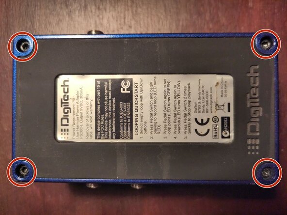

    • Unscrew the 4 Torx T15H holding the bottom plate
    • Free the bottom plate

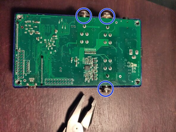

  3. Rewriting corrupted firmware on Digitech JamMan Solo, Lift the board: crwdns2935265:03crwdnd2935265:01crwdnd2935265:03crwdne2935265:0 Rewriting corrupted firmware on Digitech JamMan Solo, Lift the board: crwdns2935265:03crwdnd2935265:02crwdnd2935265:03crwdne2935265:0 Rewriting corrupted firmware on Digitech JamMan Solo, Lift the board: crwdns2935265:03crwdnd2935265:03crwdnd2935265:03crwdne2935265:0

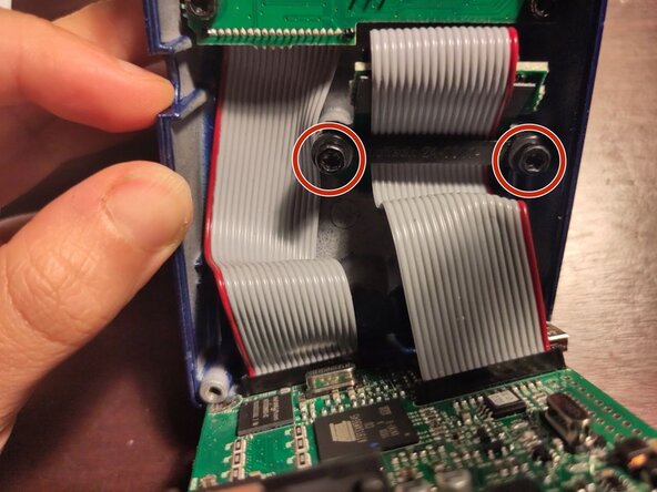

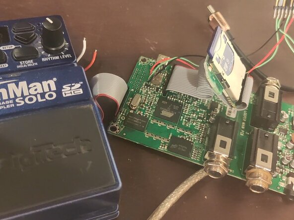

    • Unscrew the 3 jack connectors bolts
    • Lift the board from the top of the pedal

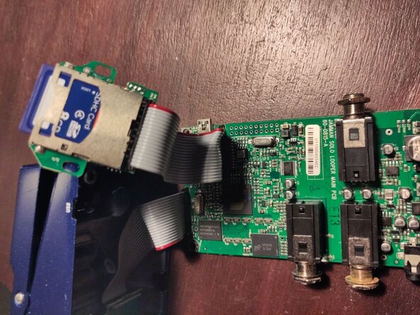

    • Unscrew the 2 Torx T15H holding the SD card
    • The board can be moved out of the pedal
    • There is no need to unmount it further to access the debug port
    • Connectors to the display and button boards and to the SD card slot are soldered, do not try to disconnect them

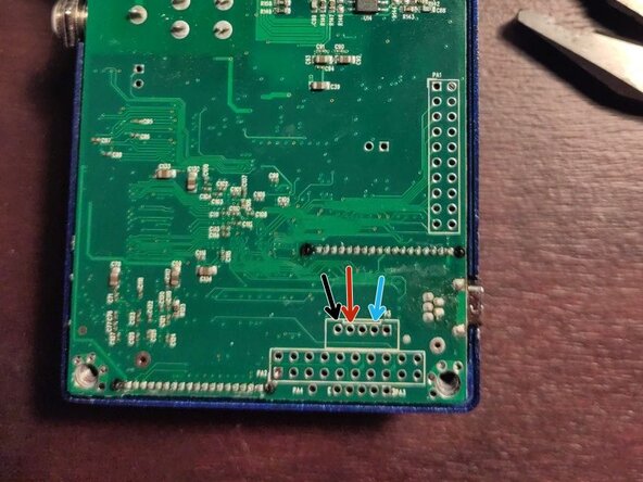

  4. Rewriting corrupted firmware on Digitech JamMan Solo, Take a look at the board: crwdns2935265:04crwdnd2935265:01crwdnd2935265:03crwdne2935265:0 Rewriting corrupted firmware on Digitech JamMan Solo, Take a look at the board: crwdns2935265:04crwdnd2935265:02crwdnd2935265:03crwdne2935265:0 Rewriting corrupted firmware on Digitech JamMan Solo, Take a look at the board: crwdns2935265:04crwdnd2935265:03crwdnd2935265:03crwdne2935265:0

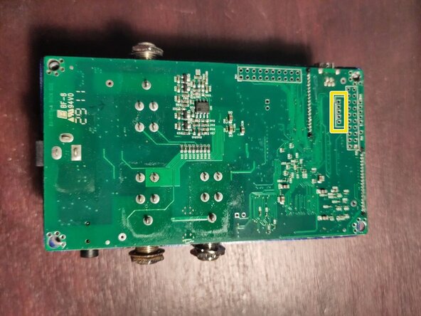

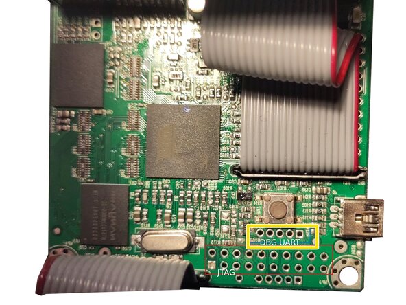

    • Spot the debug UART port
    • Under the button when looking from the top
    • Marked as "P3" when looking from the bottom
    • UART connection requires to connect TXD, RXD and GND
  5. Rewriting corrupted firmware on Digitech JamMan Solo, Solder debug UART cables: crwdns2935265:05crwdnd2935265:01crwdnd2935265:02crwdne2935265:0 Rewriting corrupted firmware on Digitech JamMan Solo, Solder debug UART cables: crwdns2935265:05crwdnd2935265:02crwdnd2935265:02crwdne2935265:0

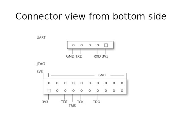

    • Solder a 3V3 USB-UART adapter to the pins by following this pinout
    • GND connected to the adapter GND
    • TX connected to the adapter RX
    • RX connected to the adapter TX
    • You can also solder an intermediate 2.54mm DuPont-style header connector and use DuPont debug cables
    • No need to connect 3V3, RTS and CTS

    • Once everything is connected, you can plug the 9V power supply to the pedal
    • It should display startup messages
    • Afterwards, it should give you a prompt with the possibility to interact with it
    • Try typing "ls"
