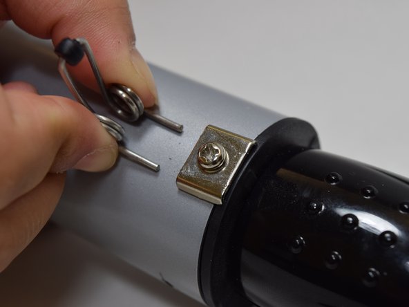

  4. Revlon RVIR1008 Swivel Cord Replacement: crwdns2935265:04crwdnd2935265:01crwdnd2935265:02crwdne2935265:0 Revlon RVIR1008 Swivel Cord Replacement: crwdns2935265:04crwdnd2935265:02crwdnd2935265:02crwdne2935265:0
    • Squeeze both sides of the barrel clip spring, and slide the component away from the barrel to remove.
    • Slowly decompress the spring after removal from spring plate to avoid any hazards.
  5. Revlon RVIR1008 Swivel Cord Replacement: crwdns2935265:05crwdnd2935265:01crwdnd2935265:02crwdne2935265:0 Revlon RVIR1008 Swivel Cord Replacement: crwdns2935265:05crwdnd2935265:02crwdnd2935265:02crwdne2935265:0
    • Remove the 3mm screw holding the metal spring plate in place with the 3.0 flathead screwdriver.
    • Place the screw and spring plate to the side for reassembly at a later time.
    • Removing this screw allows for removal of the barrel from the iron itself. Be sure not to pull on the barrel.

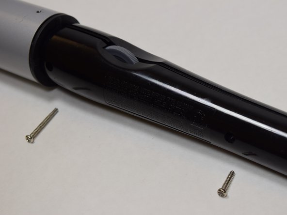

  6. Revlon RVIR1008 Swivel Cord Replacement: crwdns2935265:06crwdnd2935265:01crwdnd2935265:03crwdne2935265:0 Revlon RVIR1008 Swivel Cord Replacement: crwdns2935265:06crwdnd2935265:02crwdnd2935265:03crwdne2935265:0 Revlon RVIR1008 Swivel Cord Replacement: crwdns2935265:06crwdnd2935265:03crwdnd2935265:03crwdne2935265:0
    • Remove the two screws holding the plastic casing together using the 3.0 flathead screwdriver.
    • Remove the front plastic cover from the main body.
    • The plastic cover contains warnings, and is located on the device's handle.
    • Once completed, the inside components will be exposed.
    • Place the two screws and plastic cover to the side for reassembly.

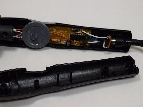

  7. Revlon RVIR1008 Swivel Cord Replacement: crwdns2935265:07crwdnd2935265:01crwdnd2935265:01crwdne2935265:0
    • Remove the cylindrical barrel shell by sliding it away from the device's main heating element.
    • Be careful to grip the device firmly and precisely to avoid stripping away the inside components underneath the handle.
  8. Revlon RVIR1008 Swivel Cord Replacement: crwdns2935265:08crwdnd2935265:01crwdnd2935265:01crwdne2935265:0
    • Carefully remove the plastic handle casing from the connected inside components, starting from the cylindrical heating element, to the black wire cord.
    • Be mindful to not misplace the On/Off buttons.
  9. Revlon RVIR1008 Swivel Cord Replacement: crwdns2935265:09crwdnd2935265:01crwdnd2935265:02crwdne2935265:0 Revlon RVIR1008 Swivel Cord Replacement: crwdns2935265:09crwdnd2935265:02crwdnd2935265:02crwdne2935265:0
    • Carefully remove the swivel cord from the female socket.
    • Place the old swivel cord to the side, and insert the new swivel cord into the female socket gently.
    • Touching the internal wiring should be done as minimally as possible in order to avoid any damage to the circuits.
