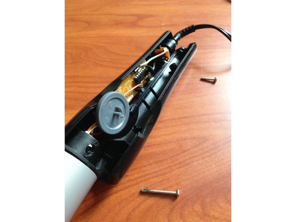

  3. Revlon RVIR1008 Disassembly, Remove the barrel clip.: crwdns2935265:03crwdnd2935265:01crwdnd2935265:02crwdne2935265:0 Revlon RVIR1008 Disassembly, Remove the barrel clip.: crwdns2935265:03crwdnd2935265:02crwdnd2935265:02crwdne2935265:0
    • Using a 3mm Flathead screwdriver, slowly remove both screws from the sides of the barrel clip.
    • Take turns unscrewing each screw . The clip is operated by a tight metal spring. Completely removing one screw first makes it difficult to unscrew the second screw.

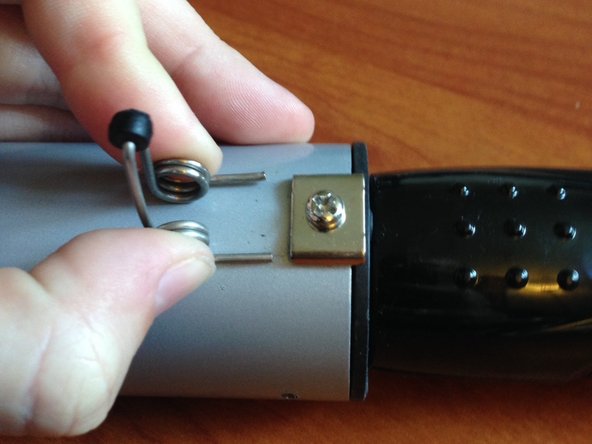

  4. Revlon RVIR1008 Disassembly, Remove the clip spring.: crwdns2935265:04crwdnd2935265:01crwdnd2935265:02crwdne2935265:0 Revlon RVIR1008 Disassembly, Remove the clip spring.: crwdns2935265:04crwdnd2935265:02crwdnd2935265:02crwdne2935265:0
    • Using two fingers, squeeze either side of the spring and slide the ends away from the barrel.

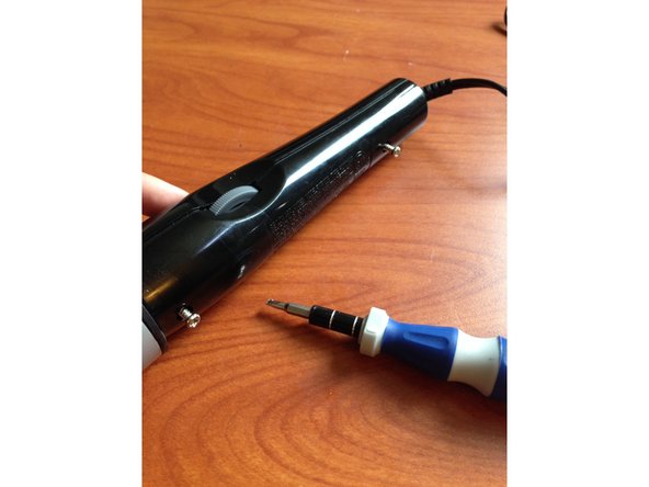

  6. Revlon RVIR1008 Disassembly, Remove the bottom of the handle.: crwdns2935265:06crwdnd2935265:01crwdnd2935265:03crwdne2935265:0 Revlon RVIR1008 Disassembly, Remove the bottom of the handle.: crwdns2935265:06crwdnd2935265:02crwdnd2935265:03crwdne2935265:0 Revlon RVIR1008 Disassembly, Remove the bottom of the handle.: crwdns2935265:06crwdnd2935265:03crwdnd2935265:03crwdne2935265:0
    • Using a 3mm Flathead Screwdriver, remove the 27mm screw on the left and the 15mm screw on the right.
    • When reassembling the curling iron, make sure to put the screws in their respective holes.
    • Once the screws are removed, the bottom plate easily comes off, exposing the inner components of the iron.

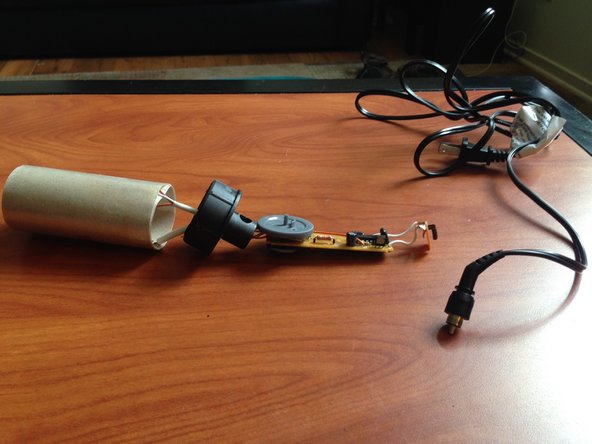

  7. Revlon RVIR1008 Disassembly, Remove the barrel shell.: crwdns2935265:07crwdnd2935265:01crwdnd2935265:01crwdne2935265:0
    • To remove the barrel, simply side the silver outer shell away from the inner heat transfer element.
    • The inner heat transfer element is attached to multiple AC power wires. When removing the barrel shell, make sure the inner heating element is not pulled away from the rest of the iron or the wires may tear off.
  8. Revlon RVIR1008 Disassembly, Remove the top of the handle.: crwdns2935265:08crwdnd2935265:01crwdnd2935265:02crwdne2935265:0 Revlon RVIR1008 Disassembly, Remove the top of the handle.: crwdns2935265:08crwdnd2935265:02crwdnd2935265:02crwdne2935265:0
    • Using your hands, slowly pull the inner components away from the top of the handle.

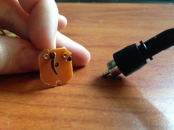

  9. Revlon RVIR1008 Disassembly, Remove the swivel cord.: crwdns2935265:09crwdnd2935265:01crwdnd2935265:03crwdne2935265:0 Revlon RVIR1008 Disassembly, Remove the swivel cord.: crwdns2935265:09crwdnd2935265:02crwdnd2935265:03crwdne2935265:0 Revlon RVIR1008 Disassembly, Remove the swivel cord.: crwdns2935265:09crwdnd2935265:03crwdnd2935265:03crwdne2935265:0
    • Using your hands, slowly pull the cord away from the socket. The cord should easily slide out of the socket.
  10. Revlon RVIR1008 Disassembly, Remove the temperature dials.: crwdns2935265:010crwdnd2935265:01crwdnd2935265:03crwdne2935265:0 Revlon RVIR1008 Disassembly, Remove the temperature dials.: crwdns2935265:010crwdnd2935265:02crwdnd2935265:03crwdne2935265:0 Revlon RVIR1008 Disassembly, Remove the temperature dials.: crwdns2935265:010crwdnd2935265:03crwdnd2935265:03crwdne2935265:0
    • Using two hands, grab each wheel and pull the temperature dials away from the circuit board.
