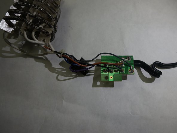

  5. Revlon RVDR5061 Heating Element Assembly Replacement, Heating Element Assembly: crwdns2935265:05crwdnd2935265:01crwdnd2935265:02crwdne2935265:0 Revlon RVDR5061 Heating Element Assembly Replacement, Heating Element Assembly: crwdns2935265:05crwdnd2935265:02crwdnd2935265:02crwdne2935265:0

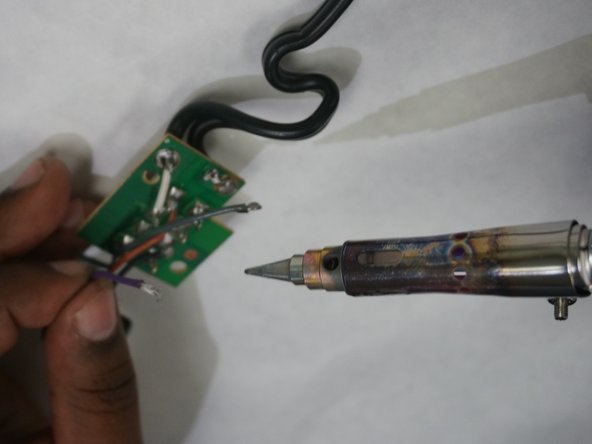

    • Once the fan/motor assembly is disconnected from the heating element assembly you will see that the heating element assembly is connected to a circuit board by four wires. The color of these wires are grey, black, purple and brown.
  6. Revlon RVDR5061 Heating Element Assembly Replacement: crwdns2935265:06crwdnd2935265:01crwdnd2935265:03crwdne2935265:0 Revlon RVDR5061 Heating Element Assembly Replacement: crwdns2935265:06crwdnd2935265:02crwdnd2935265:03crwdne2935265:0 Revlon RVDR5061 Heating Element Assembly Replacement: crwdns2935265:06crwdnd2935265:03crwdnd2935265:03crwdne2935265:0
    • Desolder these four wires one by one from the circuit board.
  7. Revlon RVDR5061 Heating Element Assembly Replacement: crwdns2935265:07crwdnd2935265:01crwdnd2935265:01crwdne2935265:0
    • The heating element assembly will now be separated from the circuit board and can be replaced with a new one.
