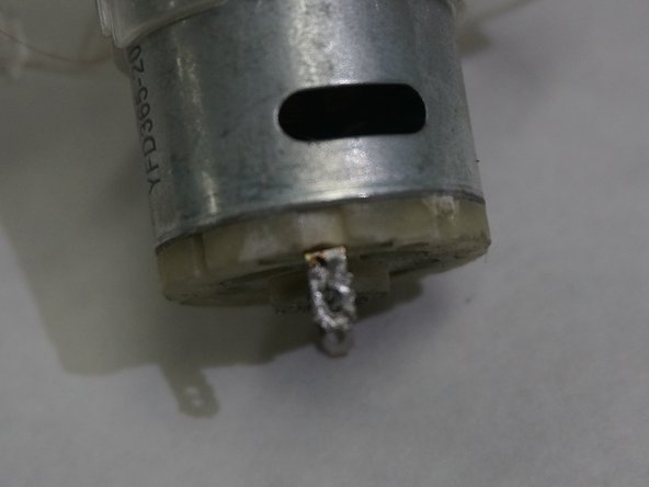

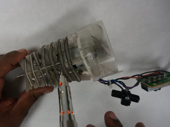

  4. Revlon RVDR5061 Fan/Motor Assembly Replacement: crwdns2935265:04crwdnd2935265:01crwdnd2935265:03crwdne2935265:0 Revlon RVDR5061 Fan/Motor Assembly Replacement: crwdns2935265:04crwdnd2935265:02crwdnd2935265:03crwdne2935265:0 Revlon RVDR5061 Fan/Motor Assembly Replacement: crwdns2935265:04crwdnd2935265:03crwdnd2935265:03crwdne2935265:0
    • The fan/motor assembly is connected to the heating element assembly at two points need to be desoldered. After pulling the attached wires through the holes the fan/motor assembly will be free from the heating element assembly. Congratulations you have now completely removed the fan/motor assembly from this hair dryer!
