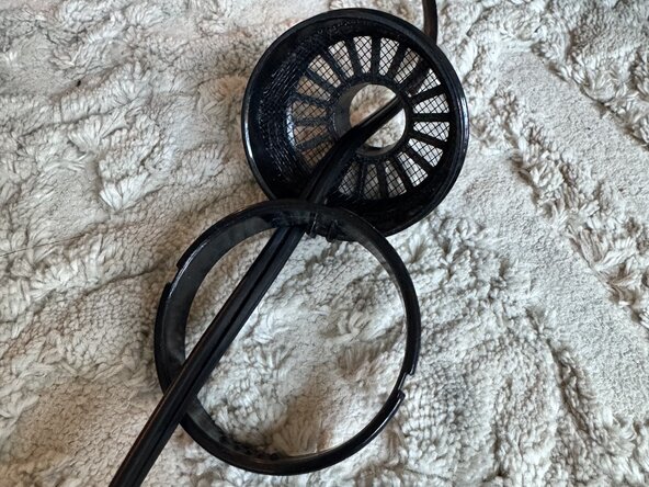

  4. Revlon One-Step Hair Dryer Brush Disassembly, Remove Air Filter & Power Indicator/Ring: crwdns2935265:04crwdnd2935265:01crwdnd2935265:03crwdne2935265:0 Revlon One-Step Hair Dryer Brush Disassembly, Remove Air Filter & Power Indicator/Ring: crwdns2935265:04crwdnd2935265:02crwdnd2935265:03crwdne2935265:0 Revlon One-Step Hair Dryer Brush Disassembly, Remove Air Filter & Power Indicator/Ring: crwdns2935265:04crwdnd2935265:03crwdnd2935265:03crwdne2935265:0
    • Twist and pull the Air Filter to remove the 2 rings. It is held in place by two lugs and holes (Circled blue on photo). Quite difficult to remove but it will come if enough force is applied
    • Slide the Power Indicator/Ring.
