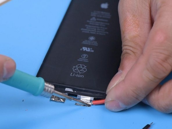

    • CAUTION: Before starting this guide, make sure that the batteries are fully drained (0%)
    • We are using old batteries from the iPhone 7 Plus and iPhone 8 Plus. Peel off the tape on the battery protector off with tweezers.
    • Please use non-conductive tweezers to avoid short-circuiting the battery.
    • Apply tin to the anode and cathode of the battery with a soldering iron at 365°C. Heat to remove the protection board.

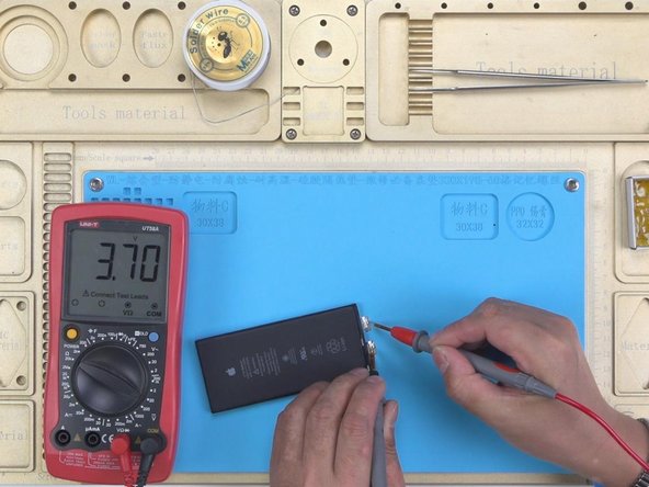

  2. Reuse Old Batteries As A Power Bank, Measure the battery voltage: crwdns2935265:02crwdnd2935265:01crwdnd2935265:03crwdne2935265:0 Reuse Old Batteries As A Power Bank, Measure the battery voltage: crwdns2935265:02crwdnd2935265:02crwdnd2935265:03crwdne2935265:0 Reuse Old Batteries As A Power Bank, Measure the battery voltage: crwdns2935265:02crwdnd2935265:03crwdnd2935265:03crwdne2935265:0
    • Measure the battery voltage with a multimeter. The voltages of the two batteries we have are 3.66V and 3.76V respectively.
    • As you can see, both batteries have the anode on the left and the cathode on the right.
    • Anode (Positive terminal)
    • Cathode (Negative terminal)
    • We are combining a 2900mAh iPhone 7+ battery with a 2675mAh iPhone 8+ battery and turning it into a 5575mAh power bank.

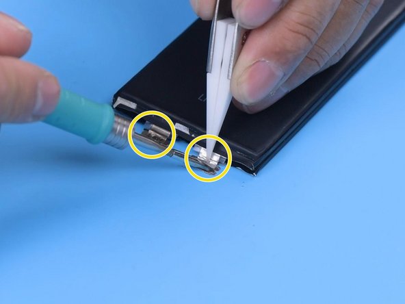

  3. Reuse Old Batteries As A Power Bank, Solder the terminals: crwdns2935265:03crwdnd2935265:01crwdnd2935265:03crwdne2935265:0 Reuse Old Batteries As A Power Bank, Solder the terminals: crwdns2935265:03crwdnd2935265:02crwdnd2935265:03crwdne2935265:0 Reuse Old Batteries As A Power Bank, Solder the terminals: crwdns2935265:03crwdnd2935265:03crwdnd2935265:03crwdne2935265:0
    • Apply double-sided tape to the battery and align the anodes and cathodes of the two batteries.
    • Solder together the anode and cathode of each battery with a soldering iron at 365°C.
    • Measure the voltage with a multimeter. Ensure the voltage is 3.7V.

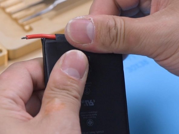

  4. Reuse Old Batteries As A Power Bank, Solder wires to the terminals: crwdns2935265:04crwdnd2935265:01crwdnd2935265:03crwdne2935265:0 Reuse Old Batteries As A Power Bank, Solder wires to the terminals: crwdns2935265:04crwdnd2935265:02crwdnd2935265:03crwdne2935265:0 Reuse Old Batteries As A Power Bank, Solder wires to the terminals: crwdns2935265:04crwdnd2935265:03crwdnd2935265:03crwdne2935265:0
    • Get a red wire and a black wire. Strip each end of both wires to expose the copper wire and apply tin on the copper wire with a soldering iron at 365°C.
    • Next, solder the red wire to the anode and the black wire to the cathode.

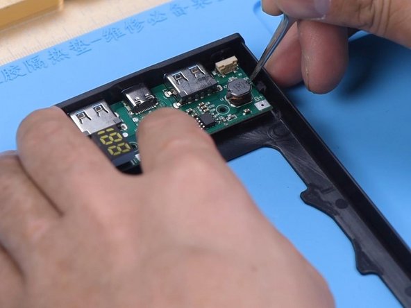

    • Install the button on the middle frame and the power board.

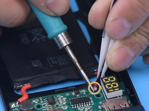

    • Apply tin on the bonding pad of the anode and cathode with a soldering iron at 365°C.

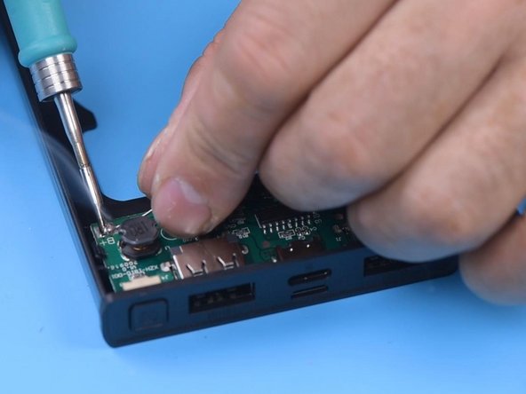

  7. Reuse Old Batteries As A Power Bank, Solder to the power board: crwdns2935265:07crwdnd2935265:01crwdnd2935265:02crwdne2935265:0 Reuse Old Batteries As A Power Bank, Solder to the power board: crwdns2935265:07crwdnd2935265:02crwdnd2935265:02crwdne2935265:0
    • Solder the anode of the battery to the anode of the power board.
    • Solder the cathode of the battery to the cathode of the power board.

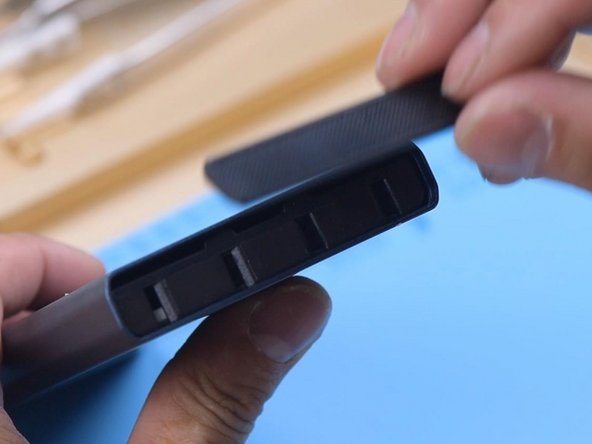

  9. Reuse Old Batteries As A Power Bank, Reattach the casing: crwdns2935265:09crwdnd2935265:01crwdnd2935265:02crwdne2935265:0 Reuse Old Batteries As A Power Bank, Reattach the casing: crwdns2935265:09crwdnd2935265:02crwdnd2935265:02crwdne2935265:0
    • Install the middle frame to the housing and put on the bottom plastic cover.

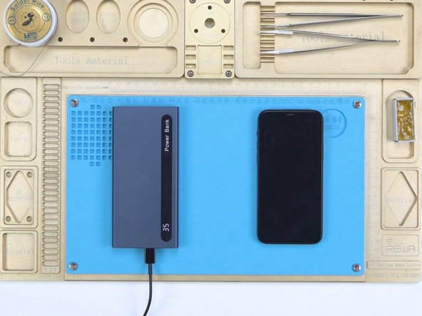

  10. Reuse Old Batteries As A Power Bank, Test charging: crwdns2935265:010crwdnd2935265:01crwdnd2935265:02crwdne2935265:0 Reuse Old Batteries As A Power Bank, Test charging: crwdns2935265:010crwdnd2935265:02crwdnd2935265:02crwdne2935265:0
    • Connect the phone to the power bank. The phone can be charged.
    • Connect the charger to the power bank. The power bank can be charged too.

I harvested a couple of batteries from old iPhones but I couldn't solder the terminals. The tin kept balling up. Then I realized that they were aluminum! Does anyone have a good method to securely connect them?
