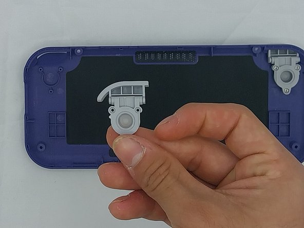

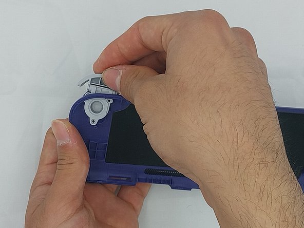

  5. Retroid Pocket 3 Trigger Button Replacement, Trigger Button: crwdns2935265:05crwdnd2935265:01crwdnd2935265:03crwdne2935265:0 Retroid Pocket 3 Trigger Button Replacement, Trigger Button: crwdns2935265:05crwdnd2935265:02crwdnd2935265:03crwdne2935265:0 Retroid Pocket 3 Trigger Button Replacement, Trigger Button: crwdns2935265:05crwdnd2935265:03crwdnd2935265:03crwdne2935265:0
    • Using the spudger, put the tip under the top round clip at the top.
    • Carefully start lifting the clip to slide it off the plastic pin on the case, tilting the trigger button as you lift it to remove.
  6. Retroid Pocket 3 Trigger Button Replacement: crwdns2935265:06crwdnd2935265:01crwdnd2935265:03crwdne2935265:0 Retroid Pocket 3 Trigger Button Replacement: crwdns2935265:06crwdnd2935265:02crwdnd2935265:03crwdne2935265:0 Retroid Pocket 3 Trigger Button Replacement: crwdns2935265:06crwdnd2935265:03crwdnd2935265:03crwdne2935265:0
    • Remove the six 4.4 mm screws on the trigger buttons with a Phillips #00 screwdriver.
    • Gently pull the trigger button through until it has come undone.
