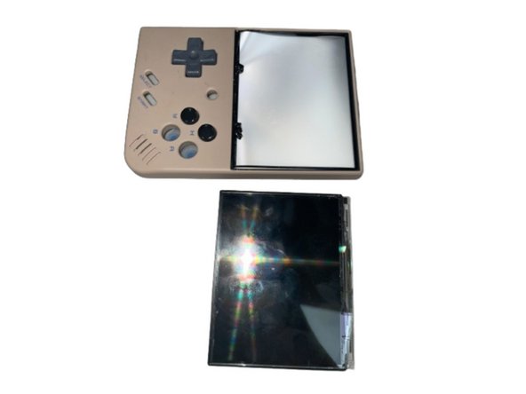

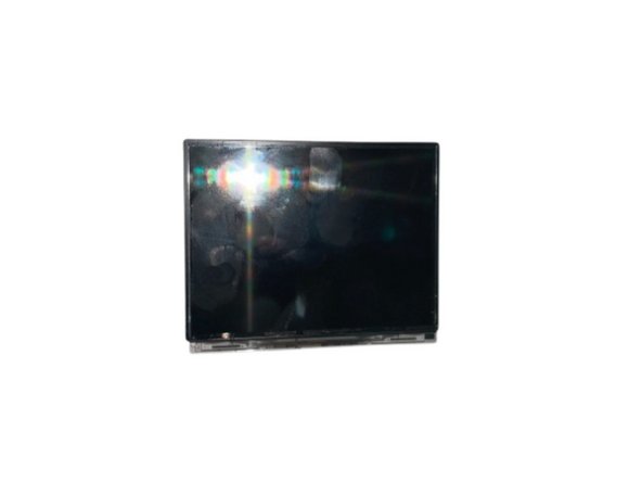

  12. RetroMini Miyoo Mini Plus Case Replacement, Screen: crwdns2935265:012crwdnd2935265:01crwdnd2935265:01crwdne2935265:0
    • Heat an iOpener according to the instructions here.
    • Rest the iOpener Gel Bag on the screen for a minute.
    • Alternatively, use a hair dryer to gently heat the screen to loosen the adhesive that secures it.
  13. RetroMini Miyoo Mini Plus Case Replacement: crwdns2935265:013crwdnd2935265:01crwdnd2935265:02crwdne2935265:0 RetroMini Miyoo Mini Plus Case Replacement: crwdns2935265:013crwdnd2935265:02crwdnd2935265:02crwdne2935265:0
    • Gently apply pressure to the highlighted area on the front cover of the device.
    • While applying the pressure gently peel the screen off of the device.
    • Take care not to flex the screen. If the screen feels stubborn, apply more heat.
  14. RetroMini Miyoo Mini Plus Case Replacement: crwdns2935265:014crwdnd2935265:01crwdnd2935265:03crwdne2935265:0 RetroMini Miyoo Mini Plus Case Replacement: crwdns2935265:014crwdnd2935265:02crwdnd2935265:03crwdne2935265:0 RetroMini Miyoo Mini Plus Case Replacement: crwdns2935265:014crwdnd2935265:03crwdnd2935265:03crwdne2935265:0
    • Set the new screen gently into the ridges (boxed in red) on the front of the backlit screen

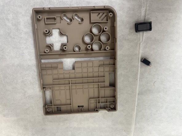

  15. RetroMini Miyoo Mini Plus Case Replacement, Case: crwdns2935265:015crwdnd2935265:01crwdnd2935265:01crwdne2935265:0
    • Remove the power and volume buttons and put them off to the side.
  16. RetroMini Miyoo Mini Plus Case Replacement: crwdns2935265:016crwdnd2935265:01crwdnd2935265:03crwdne2935265:0 RetroMini Miyoo Mini Plus Case Replacement: crwdns2935265:016crwdnd2935265:02crwdnd2935265:03crwdne2935265:0 RetroMini Miyoo Mini Plus Case Replacement: crwdns2935265:016crwdnd2935265:03crwdnd2935265:03crwdne2935265:0
    • Heat up the IFixit IOpener Gel Bag for 30 seconds once again.
    • Once heated, rest the IFixit IOpener Gel Bag on the bottom of the device for a minute.
    • Repeat this step if the glue holding the speakers on has not melted.
  17. RetroMini Miyoo Mini Plus Case Replacement: crwdns2935265:017crwdnd2935265:01crwdnd2935265:01crwdne2935265:0
    • Gently wedge an opening between the shell and the speakers and lift up.
    • Place the speakers off to the side once both are removed.
  18. RetroMini Miyoo Mini Plus Case Replacement: crwdns2935265:018crwdnd2935265:01crwdnd2935265:02crwdne2935265:0 RetroMini Miyoo Mini Plus Case Replacement: crwdns2935265:018crwdnd2935265:02crwdnd2935265:02crwdne2935265:0
    • Dispose the old shell once all of the internal parts are removed.
