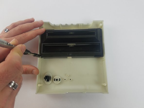

  3. Retro-Bit Retro Duo Cartridge Doors Replacement: crwdns2935265:03crwdnd2935265:01crwdnd2935265:03crwdne2935265:0 Retro-Bit Retro Duo Cartridge Doors Replacement: crwdns2935265:03crwdnd2935265:02crwdnd2935265:03crwdne2935265:0 Retro-Bit Retro Duo Cartridge Doors Replacement: crwdns2935265:03crwdnd2935265:03crwdnd2935265:03crwdne2935265:0
    • Remove the eight 10 mm Phillips #0 screws.
    • The cartridge doors are spring-loaded and may pop up.

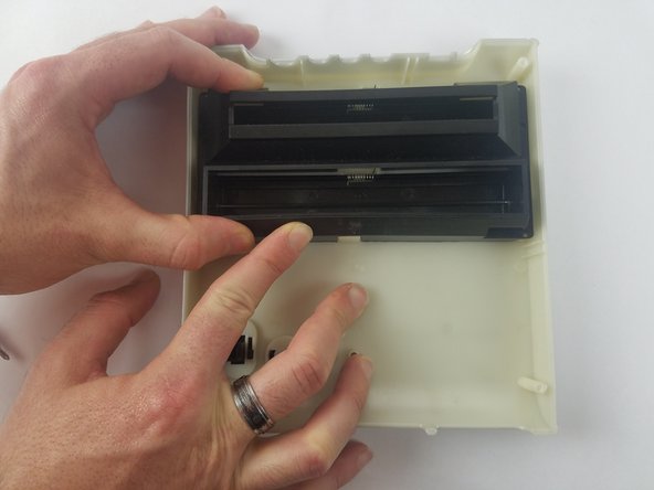

  4. Retro-Bit Retro Duo Cartridge Doors Replacement: crwdns2935265:04crwdnd2935265:01crwdnd2935265:02crwdne2935265:0 Retro-Bit Retro Duo Cartridge Doors Replacement: crwdns2935265:04crwdnd2935265:02crwdnd2935265:02crwdne2935265:0
    • Carefully lift the cartridge door case and set aside.

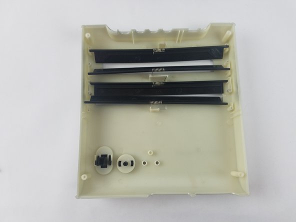

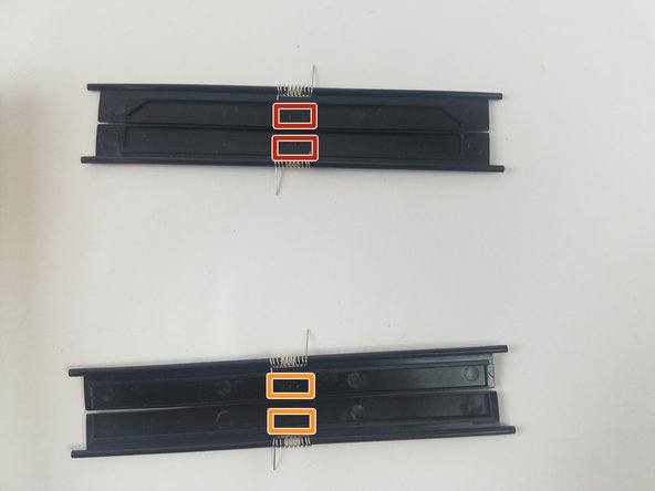

  5. Retro-Bit Retro Duo Cartridge Doors Replacement: crwdns2935265:05crwdnd2935265:01crwdnd2935265:02crwdne2935265:0 Retro-Bit Retro Duo Cartridge Doors Replacement: crwdns2935265:05crwdnd2935265:02crwdnd2935265:02crwdne2935265:0
    • Take the cartridge doors out of the top casing.
    • Keep the correct cartridge doors together. Note the door numbers and position.
    • Doors numbered two and four are for NES cartridges.
    • Doors numbered three are for SNES cartridges.
