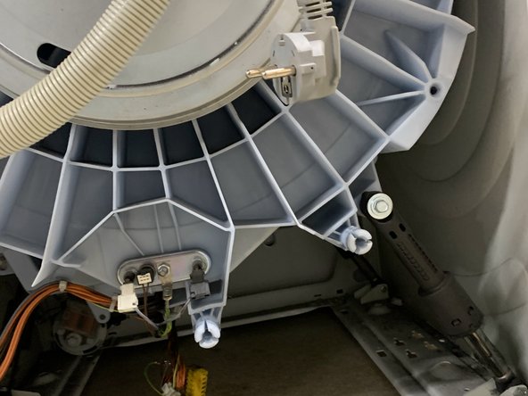

Retrieval of a washing machine motor
  1. Retrieval of a washing machine motor, Remove the back panel: crwdns2935265:01crwdnd2935265:01crwdnd2935265:01crwdne2935265:0
    • Remove the back panel of the washing machine to be able to have access and a clear view on the motor.
  2. Retrieval of a washing machine motor, Remove the screws: crwdns2935265:02crwdnd2935265:01crwdnd2935265:01crwdne2935265:0
    • Remove the screws in order to remove the motor.
  3. Retrieval of a washing machine motor, Remove the serpentine belt: crwdns2935265:03crwdnd2935265:01crwdnd2935265:01crwdne2935265:0
    • Step 3 : Remove the serpentine belt.
  4. Retrieval of a washing machine motor, Remove the chassis: crwdns2935265:04crwdnd2935265:01crwdnd2935265:01crwdne2935265:0
    • Step 4 : Using your hands and a flat screwdriver, remove the chassis of the motor by trying to pry it off, in order to detach the motor which is anchored in the washing machine.
  5. Retrieval of a washing machine motor, Result: crwdns2935265:05crwdnd2935265:01crwdnd2935265:03crwdne2935265:0 Retrieval of a washing machine motor, Result: crwdns2935265:05crwdnd2935265:02crwdnd2935265:03crwdne2935265:0 Retrieval of a washing machine motor, Result: crwdns2935265:05crwdnd2935265:03crwdnd2935265:03crwdne2935265:0
    • Once the motor has been recovered, clean it with Sopalin. Personally, we reused it.
To reassemble the machine, follow the instructions in reverse order.
