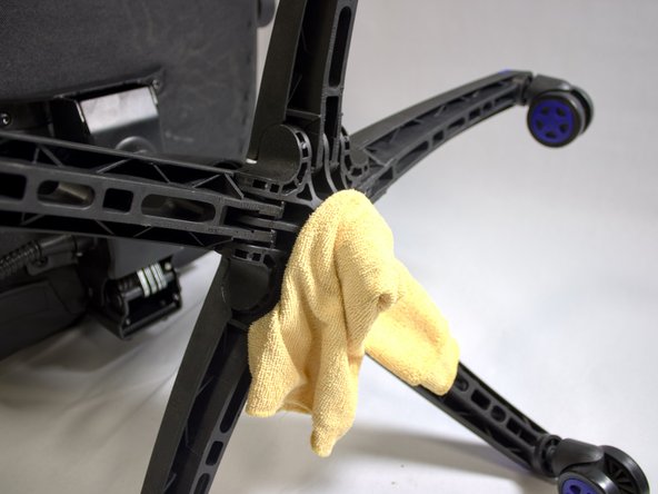

    • Optional: Place a towel over the bottom end of the cylinder to avoid damaging it in the next step.
  4. Respawn RSP-110 Gaming Chair Gas Cylinder Replacement: crwdns2935265:04crwdnd2935265:01crwdnd2935265:03crwdne2935265:0 Respawn RSP-110 Gaming Chair Gas Cylinder Replacement: crwdns2935265:04crwdnd2935265:02crwdnd2935265:03crwdne2935265:0 Respawn RSP-110 Gaming Chair Gas Cylinder Replacement: crwdns2935265:04crwdnd2935265:03crwdnd2935265:03crwdne2935265:0
    • Use rubber mallet to strike the bottom of the cylinder firmly to dislodge it.
    • If the cylinder remains lodged, continue striking it with the rubber mallet until it dislodges.
    • Exercise caution to prevent damage and avoid injury while dislodging the cylinder.

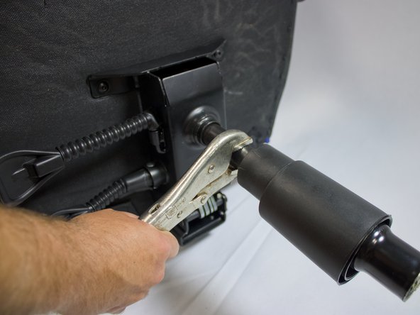

    • Using the pipe wrench/vise-grip, twist the cylinder out of place.
    • You will need to twist clockwise or counter-clockwise repeatedly until the cylinder releases.

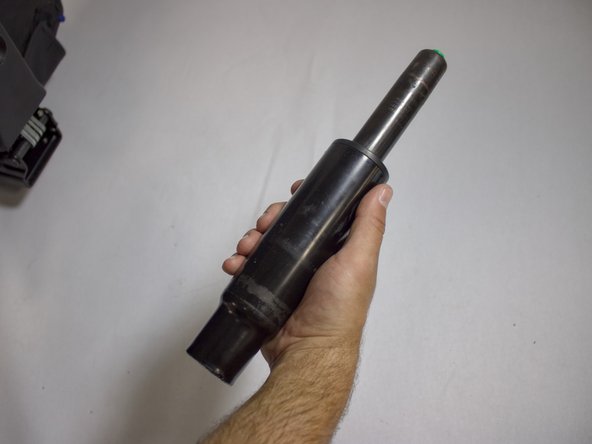

    • Get your new gas cylinder.
    • Make sure that the plastic cylinder cover is around the cylinder.

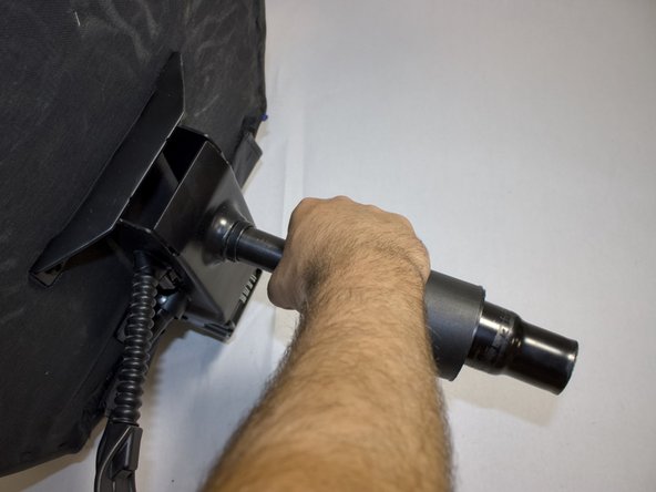

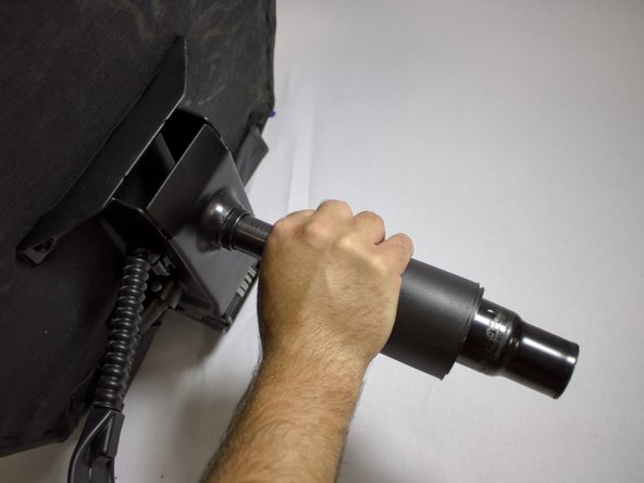

    • Attach the cylinder to the underside of the seat, and twist counterclockwise.

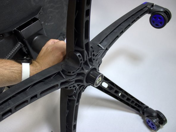

  7. Respawn RSP-110 Gaming Chair Gas Cylinder Replacement: crwdns2935265:07crwdnd2935265:01crwdnd2935265:02crwdne2935265:0 Respawn RSP-110 Gaming Chair Gas Cylinder Replacement: crwdns2935265:07crwdnd2935265:02crwdnd2935265:02crwdne2935265:0
    • Place the bottom of the cylinder into the chair base and twist to lock it just enough to safely stand it upright
    • If the cylinder is not secure enough, the chair may fall apart.
