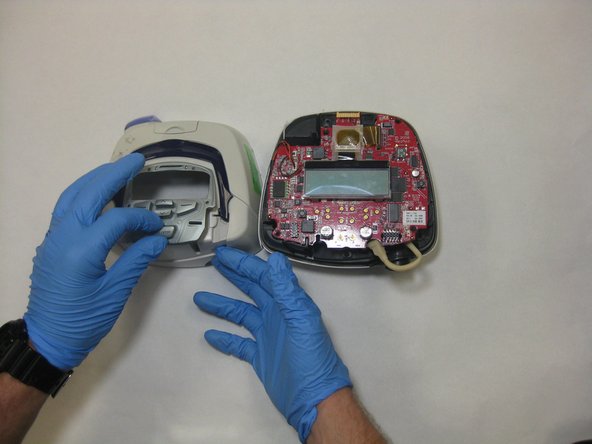

    • Remove the four 26.7 mm T3 Torx screws from the bottom side of the ResMed VPAP Auto 25.
  2. ResMed VPAP Auto 25 Motherboard Replacement: crwdns2935265:02crwdnd2935265:01crwdnd2935265:03crwdne2935265:0 ResMed VPAP Auto 25 Motherboard Replacement: crwdns2935265:02crwdnd2935265:02crwdnd2935265:03crwdne2935265:0 ResMed VPAP Auto 25 Motherboard Replacement: crwdns2935265:02crwdnd2935265:03crwdnd2935265:03crwdne2935265:0
    • Flip the device over.
    • Pry the outermost plastic cover off with the metal spudger until the cover is loose and able to be removed.
  3. ResMed VPAP Auto 25 Motherboard Replacement: crwdns2935265:03crwdnd2935265:01crwdnd2935265:02crwdne2935265:0 ResMed VPAP Auto 25 Motherboard Replacement: crwdns2935265:03crwdnd2935265:02crwdnd2935265:02crwdne2935265:0
    • Pull off the front cover to reveal the internal components.

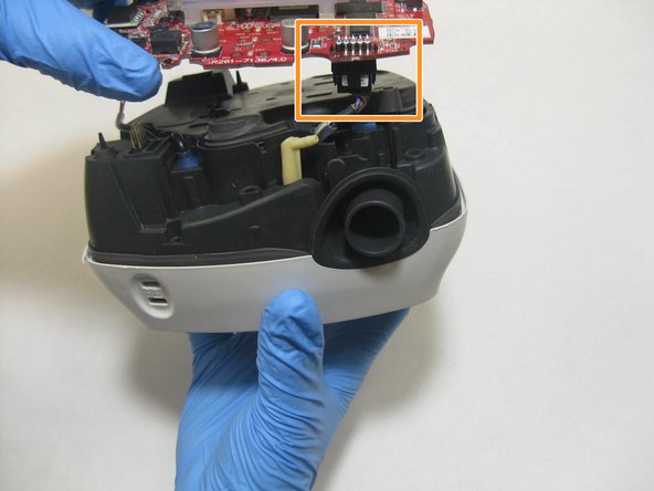

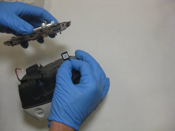

  4. ResMed VPAP Auto 25 Motherboard Replacement: crwdns2935265:04crwdnd2935265:01crwdnd2935265:03crwdne2935265:0 ResMed VPAP Auto 25 Motherboard Replacement: crwdns2935265:04crwdnd2935265:02crwdnd2935265:03crwdne2935265:0 ResMed VPAP Auto 25 Motherboard Replacement: crwdns2935265:04crwdnd2935265:03crwdnd2935265:03crwdne2935265:0
    • Loosen the motherboard from the rubber dowels holding it in place and unplug the screen components.
