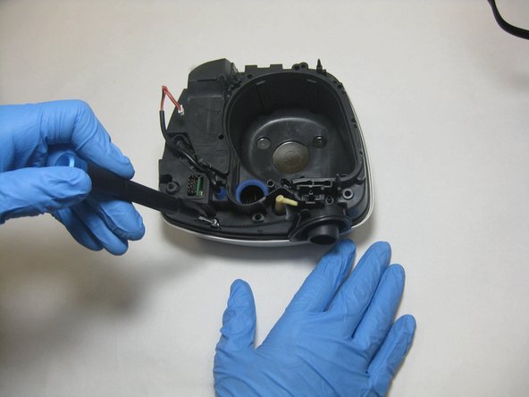

    • Flip the device over.
    • Pry the outermost plastic cover off with the metal spudger until the cover is loose and able to be removed.

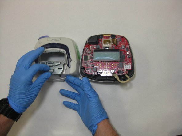

  3. ResMed VPAP Auto 25 Circuit Board Replacement: crwdns2935265:03crwdnd2935265:01crwdnd2935265:02crwdne2935265:0 ResMed VPAP Auto 25 Circuit Board Replacement: crwdns2935265:03crwdnd2935265:02crwdnd2935265:02crwdne2935265:0
    • Pull off the front cover to reveal the internal components.

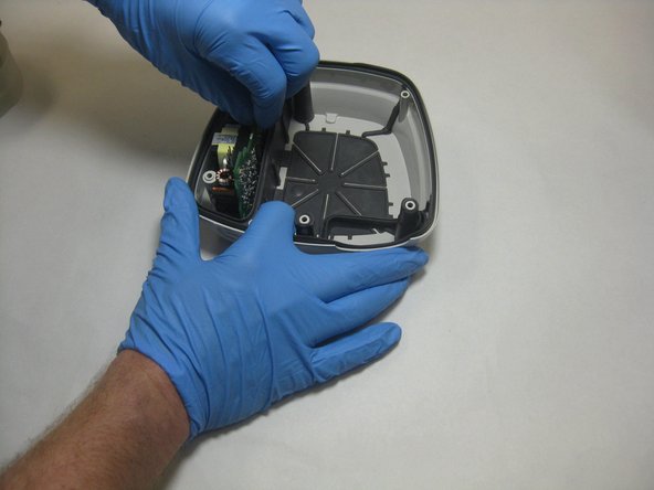

    • Loosen the motherboard from the rubber dowels holding it in place and unplug the screen components.

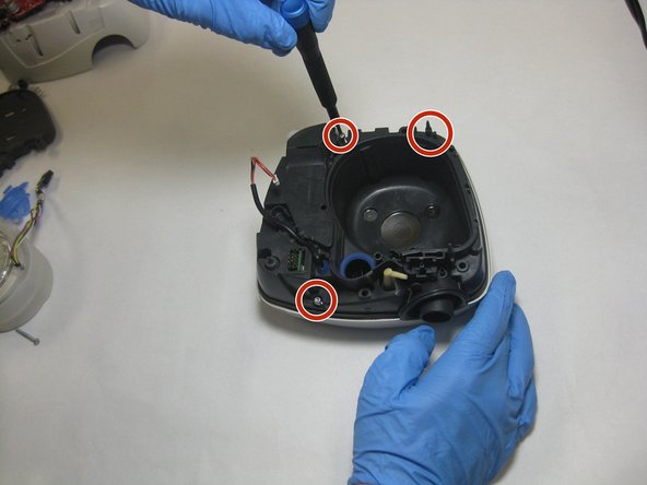

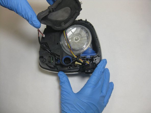

    • Remove the three 26.7 mm T3 Torx screws from the now visible rubber fan motor cover.
    • Lift off the rubber fan motor cover, revealing the fan motor.
  6. ResMed VPAP Auto 25 Circuit Board Replacement: crwdns2935265:06crwdnd2935265:01crwdnd2935265:03crwdne2935265:0 ResMed VPAP Auto 25 Circuit Board Replacement: crwdns2935265:06crwdnd2935265:02crwdnd2935265:03crwdne2935265:0 ResMed VPAP Auto 25 Circuit Board Replacement: crwdns2935265:06crwdnd2935265:03crwdnd2935265:03crwdne2935265:0

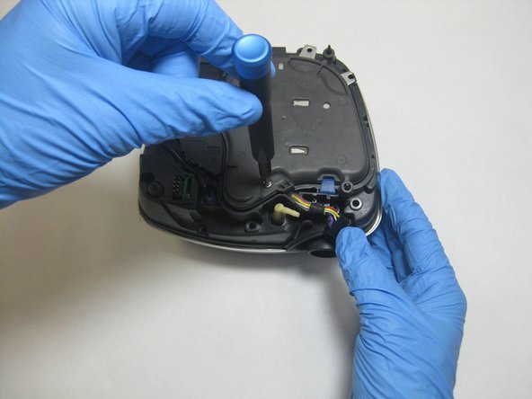

    • Remove the fan motor unit from its housing.
    • Remove the three 26.7 mm screws securing the motor housing to the bottom piece with a T3 Torx screwdriver.

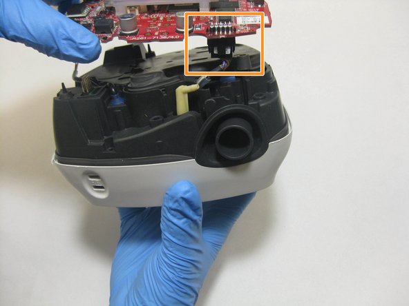

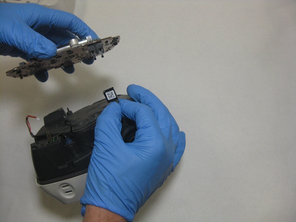

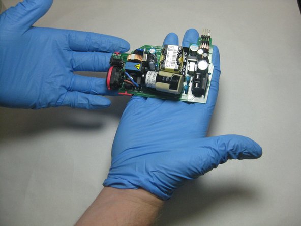

  7. ResMed VPAP Auto 25 Circuit Board Replacement: crwdns2935265:07crwdnd2935265:01crwdnd2935265:03crwdne2935265:0 ResMed VPAP Auto 25 Circuit Board Replacement: crwdns2935265:07crwdnd2935265:02crwdnd2935265:03crwdne2935265:0 ResMed VPAP Auto 25 Circuit Board Replacement: crwdns2935265:07crwdnd2935265:03crwdnd2935265:03crwdne2935265:0
    • Pull out the fan motor housing from the bottom cover, revealing a foam insulation pad and the circuit board.
    • Slide the circuit board out of its plastic grooves in the bottom cover to retrieve the desired component.
