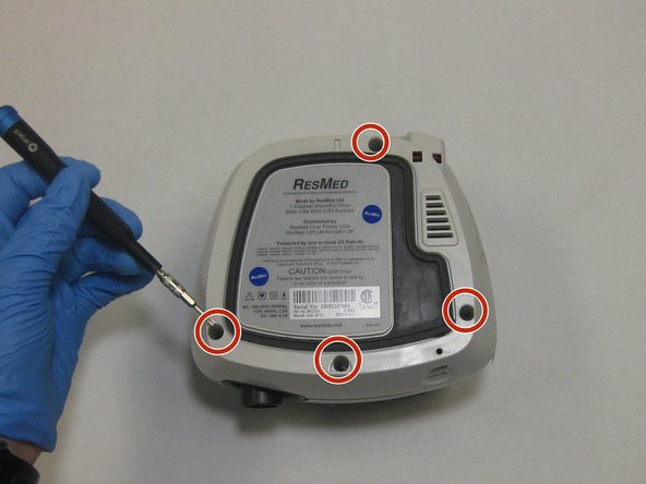

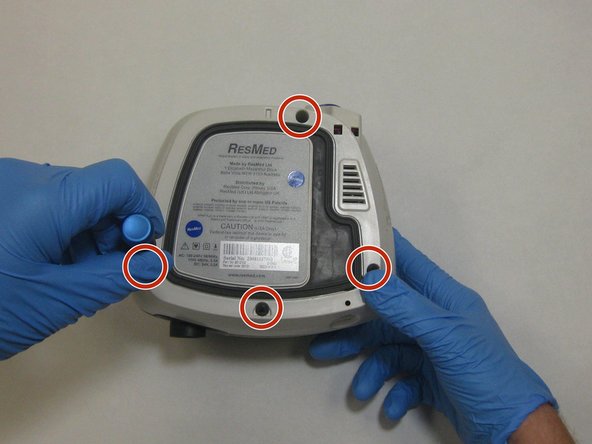

    • Remove the four 26.7 mm T3 Torx screws from the bottom side of the ResMed VPAP Auto 25.

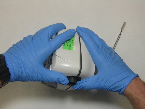

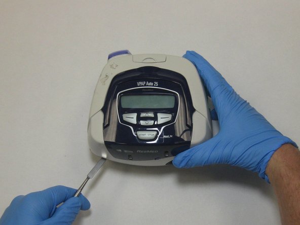

    • Flip the device over.
    • Pry the outermost plastic cover off with the metal spudger until the cover is loose and able to be removed.

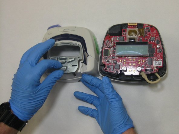

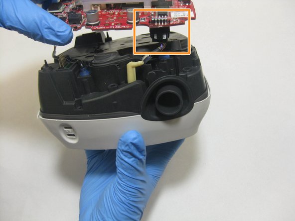

    • Pull off the front cover to reveal the internal components.
  4. ResMed VPAP Auto 25 Blower Unit Replacement Replacement: crwdns2935265:04crwdnd2935265:01crwdnd2935265:03crwdne2935265:0 ResMed VPAP Auto 25 Blower Unit Replacement Replacement: crwdns2935265:04crwdnd2935265:02crwdnd2935265:03crwdne2935265:0 ResMed VPAP Auto 25 Blower Unit Replacement Replacement: crwdns2935265:04crwdnd2935265:03crwdnd2935265:03crwdne2935265:0
    • Loosen the motherboard from the rubber dowels holding it in place and unplug the screen components.

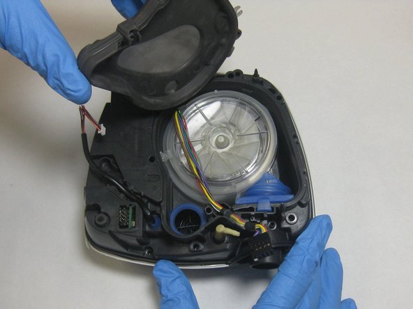

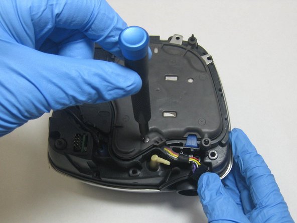

    • Remove the three 26.7 mm T3 Torx screws from the now visible rubber fan motor cover.
    • Lift off the rubber fan motor cover, revealing the fan motor.

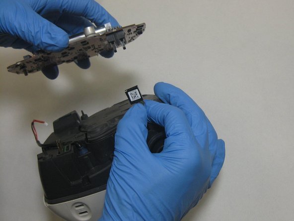

  6. ResMed VPAP Auto 25 Blower Unit Replacement Replacement: crwdns2935265:06crwdnd2935265:01crwdnd2935265:01crwdne2935265:0
    • Unplug the blower unit cable.
    • Remove the fan motor blower unit.
