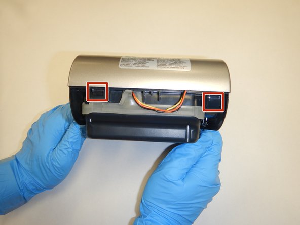

  3. ResMed S9 VPAP Auto Knob Replacement: crwdns2935265:03crwdnd2935265:01crwdnd2935265:02crwdne2935265:0 ResMed S9 VPAP Auto Knob Replacement: crwdns2935265:03crwdnd2935265:02crwdnd2935265:02crwdne2935265:0
    • Use the spudger to pry off the front panel.
    • If you are having difficulty, press the two hooks to open that side of the device.
    • Remove the front panel to expose the internal components.

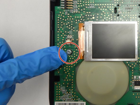

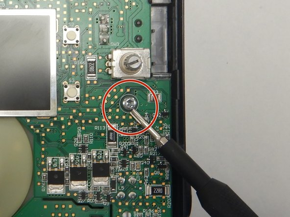

  4. ResMed S9 VPAP Auto Knob Replacement: crwdns2935265:04crwdnd2935265:01crwdnd2935265:03crwdne2935265:0 ResMed S9 VPAP Auto Knob Replacement: crwdns2935265:04crwdnd2935265:02crwdnd2935265:03crwdne2935265:0 ResMed S9 VPAP Auto Knob Replacement: crwdns2935265:04crwdnd2935265:03crwdnd2935265:03crwdne2935265:0
    • Remove the two screws on the circuit board with a T3 Torx screwdriver.

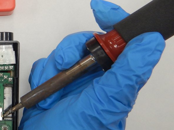

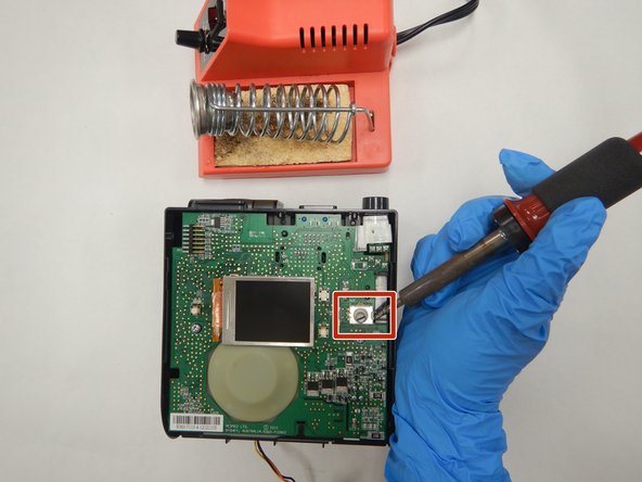

    • Plug in and heat up the soldering iron.

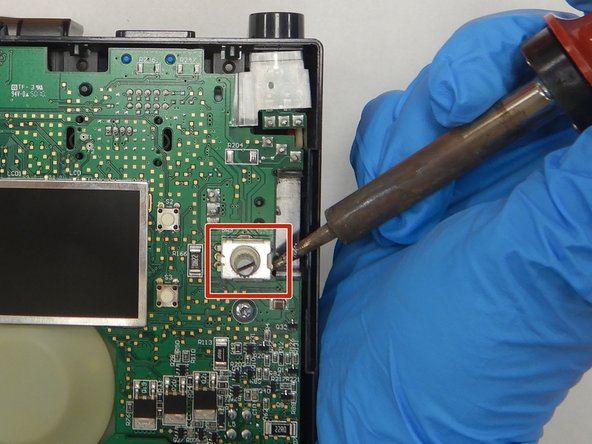

    • Locate the knob pins.
    • Desolder the solder pins on each side of the knob.
    • For more details on soldering best practices, check out our How To Solder and Desolder Connections guide.
    • Be careful not to make contact with any of the other parts of the motherboard.
    • Remove the knob and replace it.

You need a new rotary encoder, however the very popular and cheap EC11 does not work properly, you need a ddm 427 encoder, which is not very easy to find.
NG G. -
I found the right encoder from digikey. It has the wrong type of knob stem, but it works. It is the DDM 427.
Jim Burianek - crwdns2934203:0crwdne2934203:0
