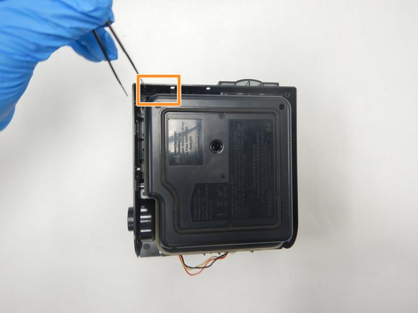

    • Flip the device upside down.
    • Use a T3 Torx screwdriver to remove the screw in the corner.
    • Each screw in this guide is a 1.2 mm Torx T3.
  2. ResMed S9 VPAP Auto Blower Replacement: crwdns2935265:02crwdnd2935265:01crwdnd2935265:02crwdne2935265:0 ResMed S9 VPAP Auto Blower Replacement: crwdns2935265:02crwdnd2935265:02crwdnd2935265:02crwdne2935265:0

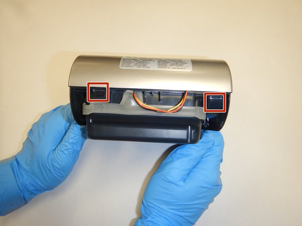

    • Use a spudger to pry off the back panel.
  3. ResMed S9 VPAP Auto Blower Replacement: crwdns2935265:03crwdnd2935265:01crwdnd2935265:02crwdne2935265:0 ResMed S9 VPAP Auto Blower Replacement: crwdns2935265:03crwdnd2935265:02crwdnd2935265:02crwdne2935265:0
    • Use the spudger to pry off the front panel.
    • If you are having difficulty, press the two hooks to open that side of the device.
    • Remove the front panel to expose the internal components.

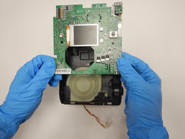

  5. ResMed S9 VPAP Auto Blower Replacement: crwdns2935265:05crwdnd2935265:01crwdnd2935265:03crwdne2935265:0 ResMed S9 VPAP Auto Blower Replacement: crwdns2935265:05crwdnd2935265:02crwdnd2935265:03crwdne2935265:0 ResMed S9 VPAP Auto Blower Replacement: crwdns2935265:05crwdnd2935265:03crwdnd2935265:03crwdne2935265:0
    • Remove the plug connecting the red, orange, and black wires to the control board.
    • The plug in the top right corner is accessed through the bottom of the device.
    • Flip the device upside down and use the tweezers to squeeze the plastic release for the remaining cable.
    • The control board will then lift right off, exposing the interior of the machine.

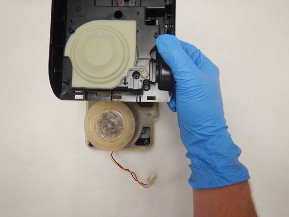

  6. ResMed S9 VPAP Auto Blower Replacement: crwdns2935265:06crwdnd2935265:01crwdnd2935265:02crwdne2935265:0 ResMed S9 VPAP Auto Blower Replacement: crwdns2935265:06crwdnd2935265:02crwdnd2935265:02crwdne2935265:0
    • Remove the five screws from the frame using a T3 Torx screwdriver.
    • Lift off the plastic frame to expose the blower housing.

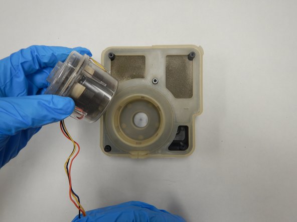

  7. ResMed S9 VPAP Auto Blower Replacement: crwdns2935265:07crwdnd2935265:01crwdnd2935265:02crwdne2935265:0 ResMed S9 VPAP Auto Blower Replacement: crwdns2935265:07crwdnd2935265:02crwdnd2935265:02crwdne2935265:0
    • Remove the silicon ring around the blower.
    • Lift the blower out of the blower housing.

I just completed this repair with a new blower motor from www.advanscpap.com and was very easy. They actually sent the complete lower housing with the blower motor which makes install simpler. Didn't need the last two steps of this tutorial. Also, a slight correction to this tutorial; the driver needed was a T10 and not a T3.
