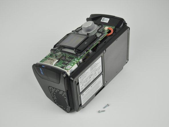

  4. ResMed AirSense 10 Wireless Communication Board Replacement: crwdns2935265:04crwdnd2935265:01crwdnd2935265:02crwdne2935265:0 ResMed AirSense 10 Wireless Communication Board Replacement: crwdns2935265:04crwdnd2935265:02crwdnd2935265:02crwdne2935265:0
    • Unscrew and remove the two 11.8 mm TR10 Torx screws from the bottom of the device.

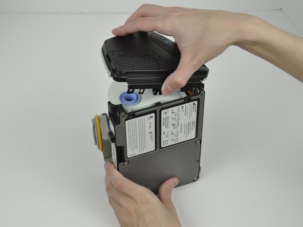

  5. ResMed AirSense 10 Wireless Communication Board Replacement: crwdns2935265:05crwdnd2935265:01crwdnd2935265:03crwdne2935265:0 ResMed AirSense 10 Wireless Communication Board Replacement: crwdns2935265:05crwdnd2935265:02crwdnd2935265:03crwdne2935265:0 ResMed AirSense 10 Wireless Communication Board Replacement: crwdns2935265:05crwdnd2935265:03crwdnd2935265:03crwdne2935265:0
    • Remove the top cover from the rest of the device.

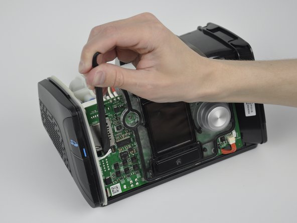

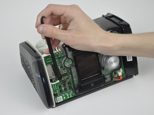

  6. ResMed AirSense 10 Wireless Communication Board Replacement, Wireless Communication Board: crwdns2935265:06crwdnd2935265:01crwdnd2935265:03crwdne2935265:0 ResMed AirSense 10 Wireless Communication Board Replacement, Wireless Communication Board: crwdns2935265:06crwdnd2935265:02crwdnd2935265:03crwdne2935265:0 ResMed AirSense 10 Wireless Communication Board Replacement, Wireless Communication Board: crwdns2935265:06crwdnd2935265:03crwdnd2935265:03crwdne2935265:0
    • Place a halberd spudger behind the connector cable.
    • Use a halberd spudger to pull the connector away from the motherboard.

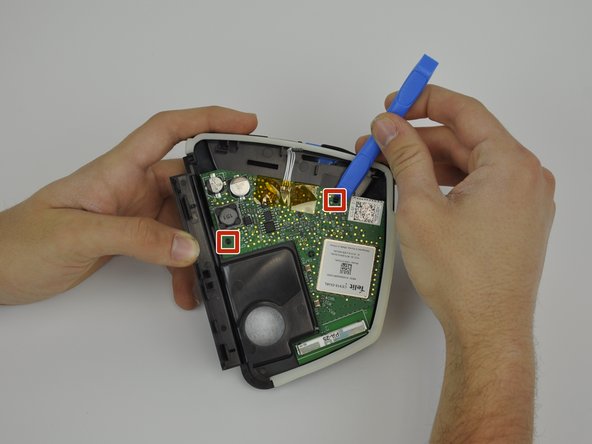

  9. ResMed AirSense 10 Wireless Communication Board Replacement: crwdns2935265:09crwdnd2935265:01crwdnd2935265:02crwdne2935265:0 ResMed AirSense 10 Wireless Communication Board Replacement: crwdns2935265:09crwdnd2935265:02crwdnd2935265:02crwdne2935265:0
    • Push in the clips which secure the board to the side panel with the plastic opening tool.
  10. ResMed AirSense 10 Wireless Communication Board Replacement: crwdns2935265:010crwdnd2935265:01crwdnd2935265:02crwdne2935265:0 ResMed AirSense 10 Wireless Communication Board Replacement: crwdns2935265:010crwdnd2935265:02crwdnd2935265:02crwdne2935265:0
    • Remove the wireless communication board from the side panel.
