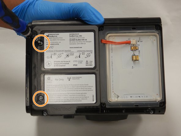

  3. ResMed AirSense 10 Pump Motor Replacement: crwdns2935265:03crwdnd2935265:01crwdnd2935265:01crwdne2935265:0
    • Remove the two 14mm Torx T10 screws that were exposed by removing the front cover plate.

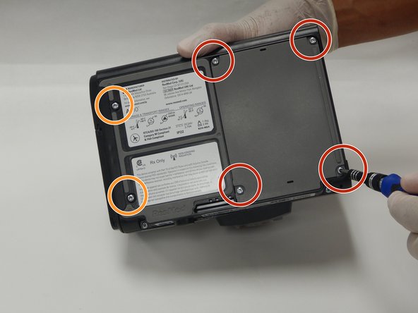

    • Rotate the device to face the bottom of the ResMed Airsense 10.
    • Remove the four 10mm Torx T10 screws, then place the screws and the plastic heater plate cover to the side.
    • Remove the remaining two 14mm Torx T10 screws.

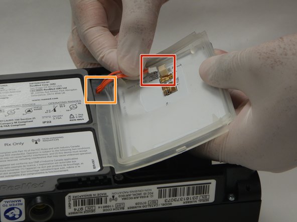

  5. ResMed AirSense 10 Pump Motor Replacement: crwdns2935265:05crwdnd2935265:01crwdnd2935265:03crwdne2935265:0 ResMed AirSense 10 Pump Motor Replacement: crwdns2935265:05crwdnd2935265:02crwdnd2935265:03crwdne2935265:0 ResMed AirSense 10 Pump Motor Replacement: crwdns2935265:05crwdnd2935265:03crwdnd2935265:03crwdne2935265:0

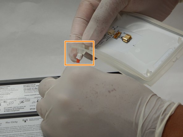

    • Once you have removed the cover of the heating plate, disconnect the orange wire from the fuse.
    • Carefully pull the orange wire through the silicone gasket.
    • Fully remove the heater plate from the ResMed Airsense 10.

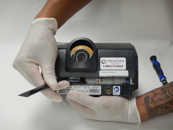

  7. ResMed AirSense 10 Pump Motor Replacement: crwdns2935265:07crwdnd2935265:01crwdnd2935265:02crwdne2935265:0 ResMed AirSense 10 Pump Motor Replacement: crwdns2935265:07crwdnd2935265:02crwdnd2935265:02crwdne2935265:0
    • Orient the ResMed AirSense 10 to face the rear of the machine. The air outlet should be facing towards you.
    • Use the plastic spudger to pry the casing of the ResMed AirSense 10 off of the unit.
    • Fully remove the casing from the ResMed frame.

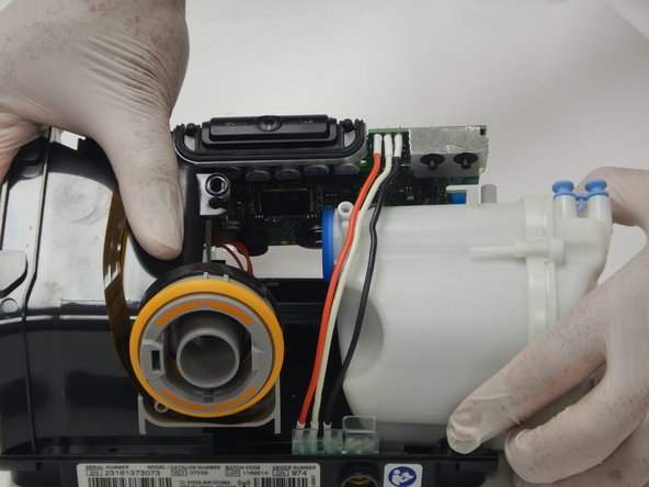

  9. ResMed AirSense 10 Pump Motor Replacement: crwdns2935265:09crwdnd2935265:01crwdnd2935265:03crwdne2935265:0 ResMed AirSense 10 Pump Motor Replacement: crwdns2935265:09crwdnd2935265:02crwdnd2935265:03crwdne2935265:0 ResMed AirSense 10 Pump Motor Replacement: crwdns2935265:09crwdnd2935265:03crwdnd2935265:03crwdne2935265:0
    • Position the ResMed AirSense 10 with the air outlet facing you.
    • Remove the 14mm Torx T10 screw that is located between the air outlet and the front screen.
    • Remove the wires from the pump casing's hook.
    • Carefully start to remove the pump casing from the Resmed AirSense 10 until the wire connector is exposed.

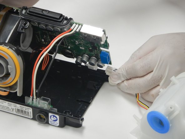

  10. ResMed AirSense 10 Pump Motor Replacement: crwdns2935265:010crwdnd2935265:01crwdnd2935265:02crwdne2935265:0 ResMed AirSense 10 Pump Motor Replacement: crwdns2935265:010crwdnd2935265:02crwdnd2935265:02crwdne2935265:0
    • Unclamp the connector for the wires that connect the pump casing to the motherboard to fully disconnect the pump.

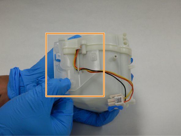

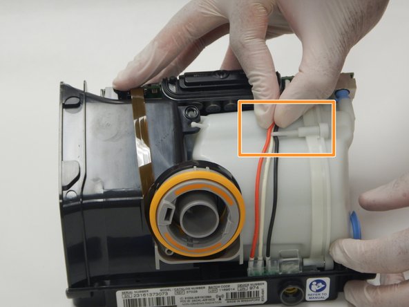

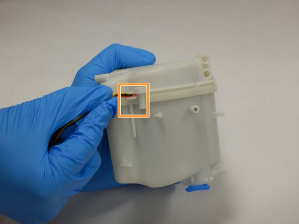

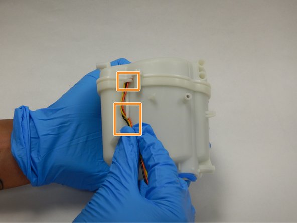

  11. ResMed AirSense 10 Pump Motor Replacement: crwdns2935265:011crwdnd2935265:01crwdnd2935265:03crwdne2935265:0 ResMed AirSense 10 Pump Motor Replacement: crwdns2935265:011crwdnd2935265:02crwdnd2935265:03crwdne2935265:0 ResMed AirSense 10 Pump Motor Replacement: crwdns2935265:011crwdnd2935265:03crwdnd2935265:03crwdne2935265:0
    • Orient the pump casing with the wires facing towards you.
    • Unhook the wires from the outer most clip.
    • Then remove the plastic retainer from the pump casing.

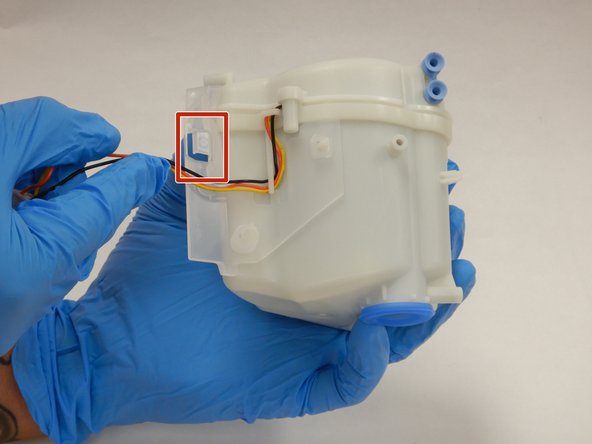

  12. ResMed AirSense 10 Pump Motor Replacement: crwdns2935265:012crwdnd2935265:01crwdnd2935265:03crwdne2935265:0 ResMed AirSense 10 Pump Motor Replacement: crwdns2935265:012crwdnd2935265:02crwdnd2935265:03crwdne2935265:0 ResMed AirSense 10 Pump Motor Replacement: crwdns2935265:012crwdnd2935265:03crwdnd2935265:03crwdne2935265:0
    • Remove the blue silicone buffer to right corner.
    • Remove the wires from the remaining hooks.

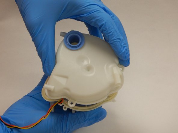

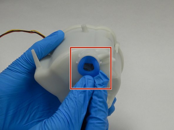

  13. ResMed AirSense 10 Pump Motor Replacement: crwdns2935265:013crwdnd2935265:01crwdnd2935265:02crwdne2935265:0 ResMed AirSense 10 Pump Motor Replacement: crwdns2935265:013crwdnd2935265:02crwdnd2935265:02crwdne2935265:0
    • Orient the pump casing to face the outlet port.
    • Push the outlet nipple into the pump housing.

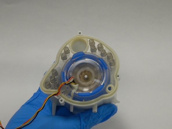

  15. ResMed AirSense 10 Pump Motor Replacement: crwdns2935265:015crwdnd2935265:01crwdnd2935265:03crwdne2935265:0 ResMed AirSense 10 Pump Motor Replacement: crwdns2935265:015crwdnd2935265:02crwdnd2935265:03crwdne2935265:0 ResMed AirSense 10 Pump Motor Replacement: crwdns2935265:015crwdnd2935265:03crwdnd2935265:03crwdne2935265:0
    • Remove the pump assembly from the pump casing and face the pump assembly with the mounting plate facing you.
    • With the pump assembly out of the pump, there is a mounting plate that needs to be removed to access the pump.
    • There are 5 rubber ridges connecting the mounting plate to the rubber sock encasing the pump.
    • Push the ridges through the holes in the mounting plate.

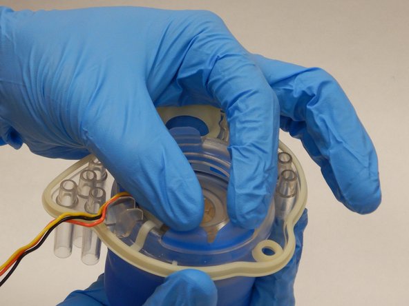

  16. ResMed AirSense 10 Pump Motor Replacement: crwdns2935265:016crwdnd2935265:01crwdnd2935265:01crwdne2935265:0
    • Separate the mounting plate from the rubber sock.

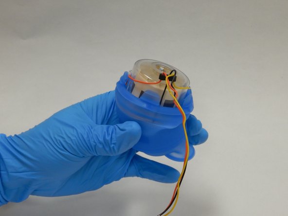

  17. ResMed AirSense 10 Pump Motor Replacement: crwdns2935265:017crwdnd2935265:01crwdnd2935265:03crwdne2935265:0 ResMed AirSense 10 Pump Motor Replacement: crwdns2935265:017crwdnd2935265:02crwdnd2935265:03crwdne2935265:0 ResMed AirSense 10 Pump Motor Replacement: crwdns2935265:017crwdnd2935265:03crwdnd2935265:03crwdne2935265:0
    • Pull off the rubber sock to expose the pump.
    • Do not damage the wires while removing the rubber sock.
    • The exposed pump can now be cleaned and inspected for damage.
