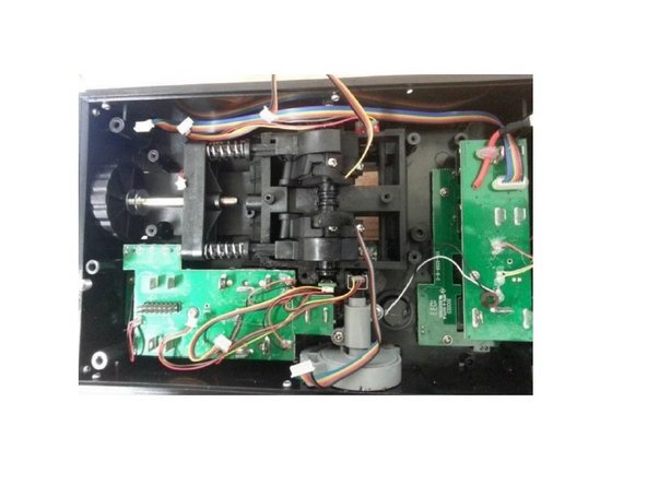

Replacing the friction pads
  1. Replacing the friction pads, Open the Throttle: crwdns2935265:01crwdnd2935265:01crwdnd2935265:03crwdne2935265:0 Replacing the friction pads, Open the Throttle: crwdns2935265:01crwdnd2935265:02crwdnd2935265:03crwdne2935265:0 Replacing the friction pads, Open the Throttle: crwdns2935265:01crwdnd2935265:03crwdnd2935265:03crwdne2935265:0

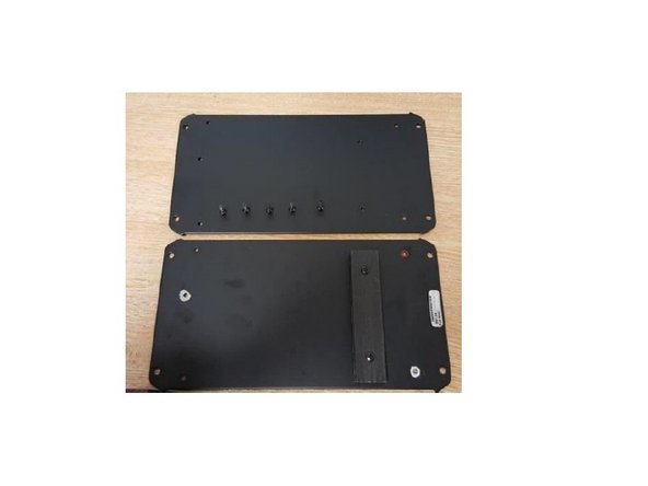

    • Unscrew these 5 screws
    • Remove the metal plate

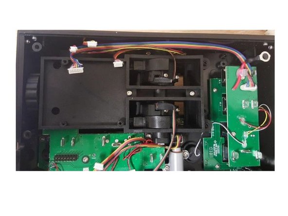

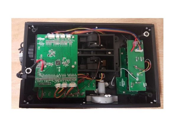

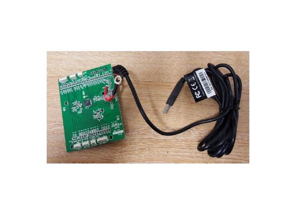

  2. Replacing the friction pads, Remove the PCB: crwdns2935265:02crwdnd2935265:01crwdnd2935265:03crwdne2935265:0 Replacing the friction pads, Remove the PCB: crwdns2935265:02crwdnd2935265:02crwdnd2935265:03crwdne2935265:0 Replacing the friction pads, Remove the PCB: crwdns2935265:02crwdnd2935265:03crwdnd2935265:03crwdne2935265:0
    • Unscrew the 4 screws, disconnect all the connectors and take off the PCB
    • Remove the 4 screws, disconnect all wires and remove the PCB.

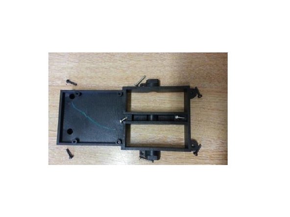

  3. Replacing the friction pads, Remove the screws: crwdns2935265:03crwdnd2935265:01crwdnd2935265:03crwdne2935265:0 Replacing the friction pads, Remove the screws: crwdns2935265:03crwdnd2935265:02crwdnd2935265:03crwdne2935265:0 Replacing the friction pads, Remove the screws: crwdns2935265:03crwdnd2935265:03crwdnd2935265:03crwdne2935265:0
    • Remove 8 screws highlighted on the picture.

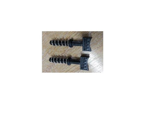

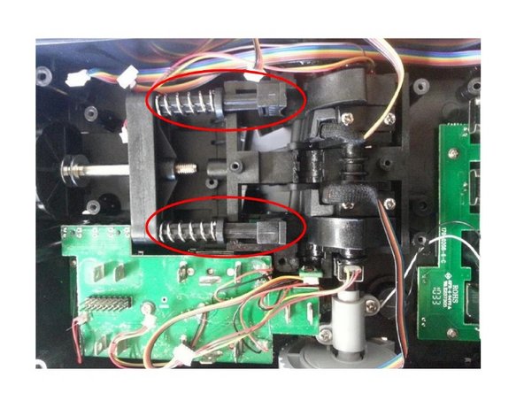

  4. Replacing the friction pads, Remove the friction pads: crwdns2935265:04crwdnd2935265:01crwdnd2935265:03crwdne2935265:0 Replacing the friction pads, Remove the friction pads: crwdns2935265:04crwdnd2935265:02crwdnd2935265:03crwdne2935265:0 Replacing the friction pads, Remove the friction pads: crwdns2935265:04crwdnd2935265:03crwdnd2935265:03crwdne2935265:0
    • Push the lever arms to gain access to the friction pads.
    • You can now remove the Friction pads
    • You can now change your friction pads
Reassemble the product by following this procedure in reverse order.
