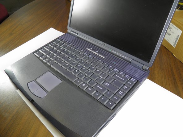

    • The parts of the laptop that will be referenced throughout this guide follow.
    • The power panel is shown in the first photo.

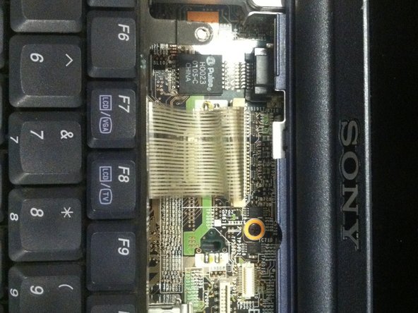

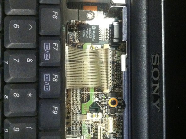

    • The power panel ribbon is located on the back of the power panel. This is the white ribbon in the second photo.
    • The keyboard and keyboard ribbon are located within the red box highlighted in the third photo.

    • Open the laptop.

    • Detach the keyboard ribbon cable from the motherboard.
    • Lift the top latch of the plastic connection piece. Once the latch is lifted, pull the ribbon cable out and slide the keyboard out.

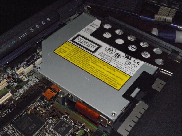

    • Photo three shows the DVD drive once the power panel and keyboard tray have been removed.
  4. Replacing the Sony Vaio PCG-981L DVD drive: crwdns2935265:04crwdnd2935265:01crwdnd2935265:03crwdne2935265:0 Replacing the Sony Vaio PCG-981L DVD drive: crwdns2935265:04crwdnd2935265:02crwdnd2935265:03crwdne2935265:0 Replacing the Sony Vaio PCG-981L DVD drive: crwdns2935265:04crwdnd2935265:03crwdnd2935265:03crwdne2935265:0
    • Remove the first screw from the DVD drive with a Phillips screwdriver. Refer to the first photo for the location of the screw.
    • Remove the second screw from the DVD drive with a Phillips screwdriver. Refer to the second photo for the location of the screw.

    • Reattach the keyboard ribbon cable to the motherboard by sliding the ribbon cable into the plastic connector and then pushing top down to latch it, then sliding the keyboard back into place.
