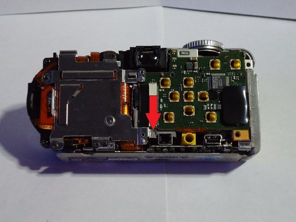

    • Begin by removing the small piece of black foam located at the top right of the LCD screen. (Picture 1)
    • Remove screw which is located exactly where the black foam was. (Picture 1)

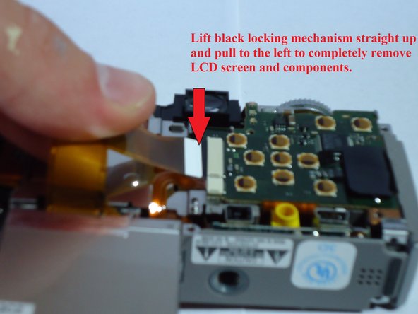

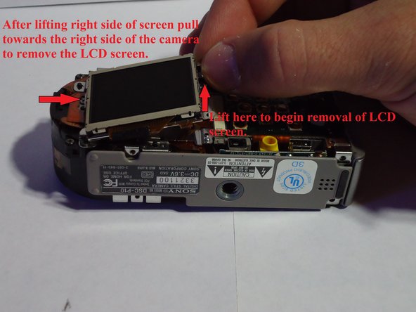

    • After screw is removed lift right side of LCD screen straight upward and pull to towards the right side of the camera. (Picture 2)
    • The LCD screen will pull out of the camera and 2 ribbon circuits will need to be detached.
    • Detach both by carefully pulling out of black locking mechanism. (Picture 3)
