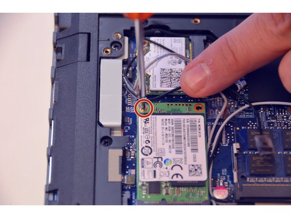

    1. Replacing the SSD, SSD disk: crwdns2935265:04crwdnd2935265:01crwdnd2935265:03crwdne2935265:0 Replacing the SSD, SSD disk: crwdns2935265:04crwdnd2935265:02crwdnd2935265:03crwdne2935265:0 Replacing the SSD, SSD disk: crwdns2935265:04crwdnd2935265:03crwdnd2935265:03crwdne2935265:0
      • This is the SSD drive
      • Unscrew the fixing screw of the SSD using the Philips # 0 screwdriver.
      • Remove the SSD.
    2. Replacing the SSD: crwdns2935265:05crwdnd2935265:01crwdnd2935265:01crwdne2935265:0
      • Here is the SSD drive out of its slot.
For reassembly, follow the instructions in reverse order.
