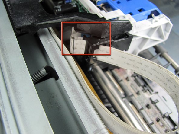

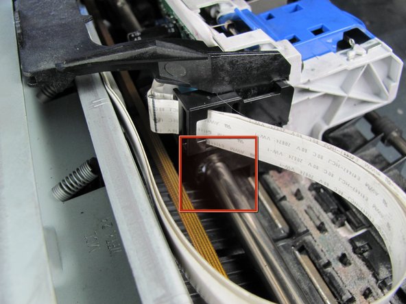

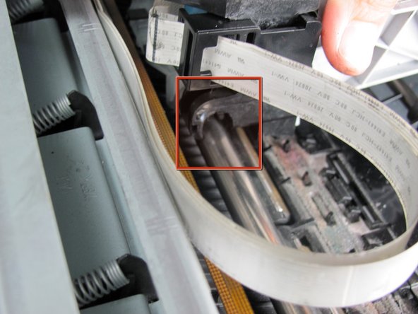

    • Slide the printer carriage to the center of the printer.
    • Disconnect the printer carriage from the rod one side at a a time by pulling upward from the bottom.
    • Unhooking the printer carriage is difficult and will require a fair amount of force.
    • The plastic strip that guides the carriage is fragile and can be broken easily.

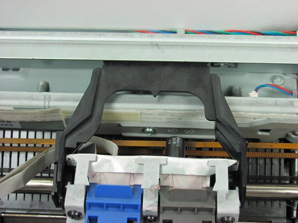

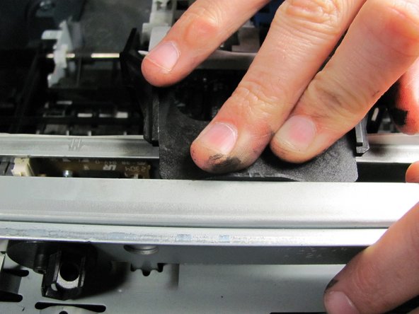

    • Place new printer carriage on the carriage rod one side at a time.
    • For proper reassembly, place the printer carriage’s black lip beneath the overhanging metal flap located at the back of the printer.
